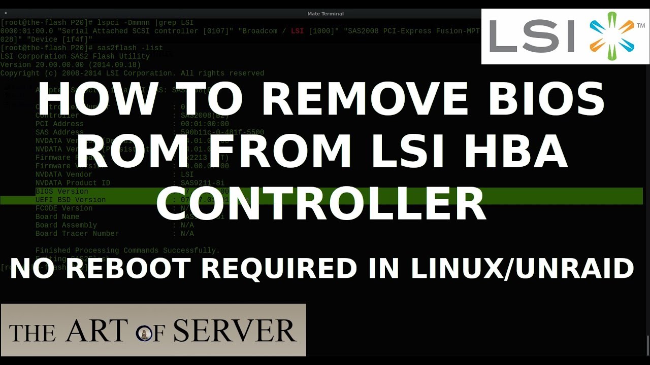

check out this vid, and channel, from a shop who sells on YT, bout does great vids:
The vid is mainly about how but, kind of explains Why from 06:40

The hi light of the vid I posted, is if you clear the bios, you can’t boot from a device connected to it, and drives won’t show up in UEFI/BIOS screen as connected.
Once the OS loads, it will have the drivers for the card, and populate the device tree with drives and stuff.
