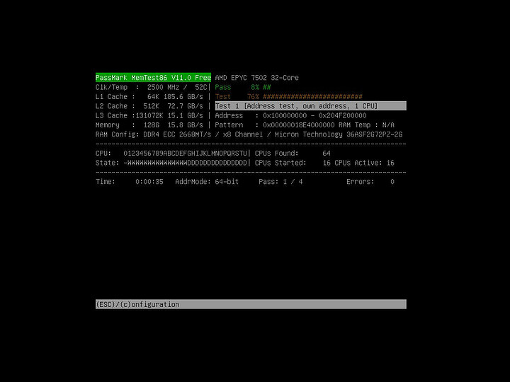

Might really be an issue with memtest then. Perhaps it is polling ECC, and this is slowing things down? Is there an option to switch this off? Or it has bad support for epyc ?
You could also try another memtest, perhaps the one of passmark?
With MemTest86 it’s a different story altogether! :smiley:
