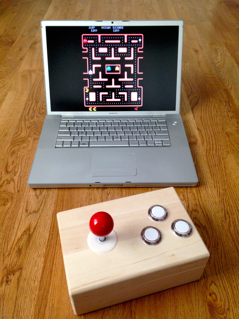

Found this site a while back. It details the selection of components of building a joystick, and it is a bit outdated regarding a few of the sites that it links to. The creator of the site does provide an example in building a joystick (case and all).
If you aren’t willing to follow that site, there is a joystick that is for sale that will allow for cross-platform use. According to the reviews (I haven’t bought it), this joystick is easily modifiable (swapping out joysticks and buttons).
