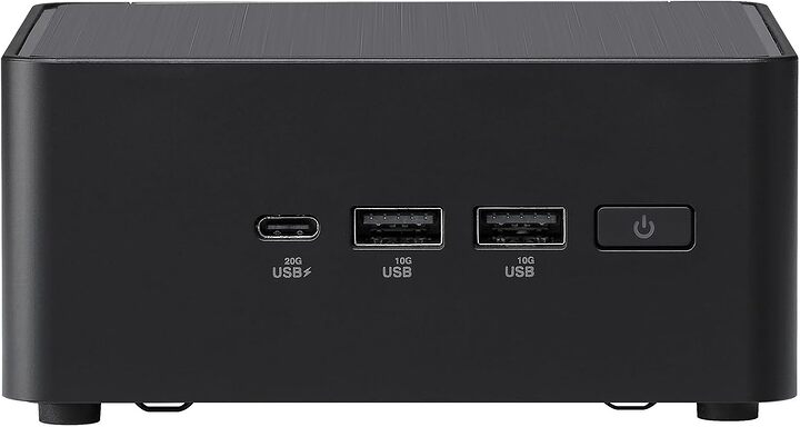

My advice, buy an Intel NUC or AMD laptop-in-a-box NUC-alike. Small, sips power and does everything you want of it.
except IPMI/BMC and even doing a PiKVM isnt guaranteed to work since most have the power pins soldered.

Up to 96GB RAM and has everything you want including vPro (the consumer version of IPMI). Only lacking ECC, but ECC is not really necessary for your usecase in any case. Add another $800 for RAM and the above 8TB drive, and you should be golden.
In my opinion, the NUC wins. But you know your use case best. :slight_smile:
