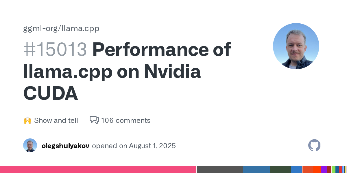

For inference, yes - when the model fits within VRAM. See the best-case scenario here:
…versus the R9700 with Vulkan here:
Spark FA on - 3661 / 56 (PP/TG)
R9700 FA on - 5620 / 139
The Spark isn’t designed for inference workloads, and the gap grows when you add a second R9700 - the TG performance stays roughly the same, but the PP performance grows by 30-40%.
