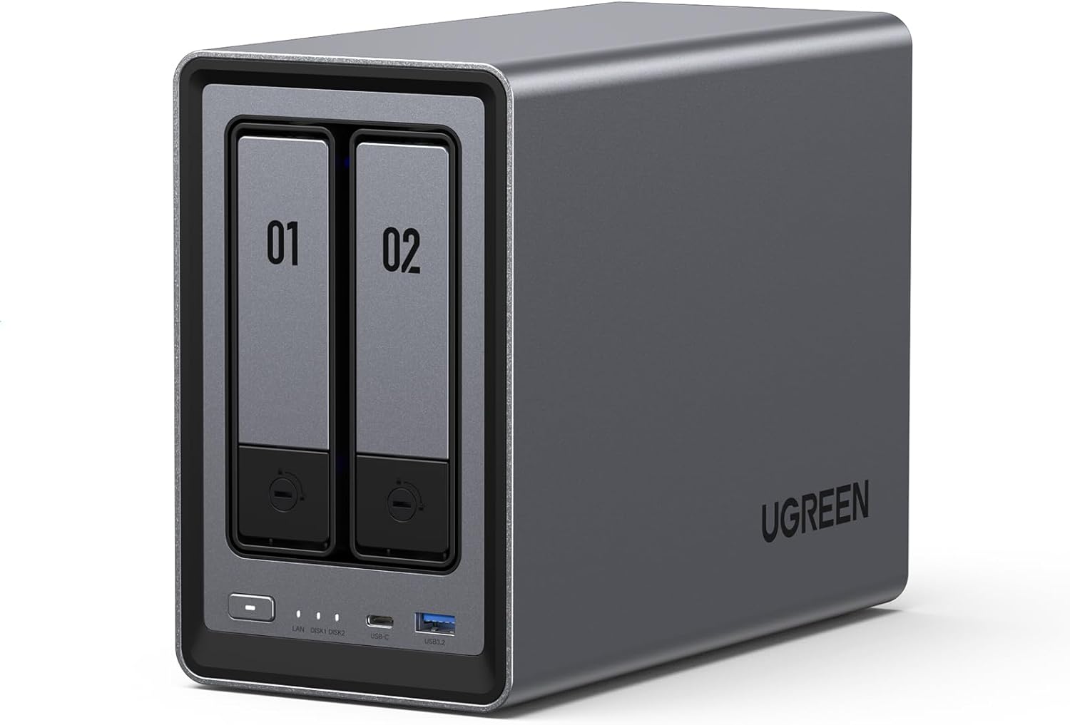

  5. Ditch the internal HDD and go full on NAS instead. Not only do you get a better and more powerful storage solution, you also get an expandable solution. A 10GB ethernet connection is slightly stronger than a NAS in either case.

If you already got the HDD, buying a NAS is not that much more expensive and trust me, you will appreciate it. Since you said EU I will assume Germany. Here is a good bare bone NAS with a 2.5G interface:

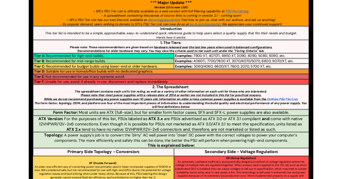

Do you need a god tier PSU or is it okay if it is somewhat basic but functional with 10 year warranty? Because you can find a lot of sub-€100 in this Google Spreadsheet…

Power supply is the least of my worries, it is very cheap to get a brand new one, the Corsair i was looking at is, maybe 200 USD, i found it as low as 180 brand new, so that’s 100% not worth the 30-50 USD saving to get something cheaper. I can save 10 times that amount by getting just one stick of 32 GB or Ram, in stead of two. (And this i am really considering as a viable option at this point)
