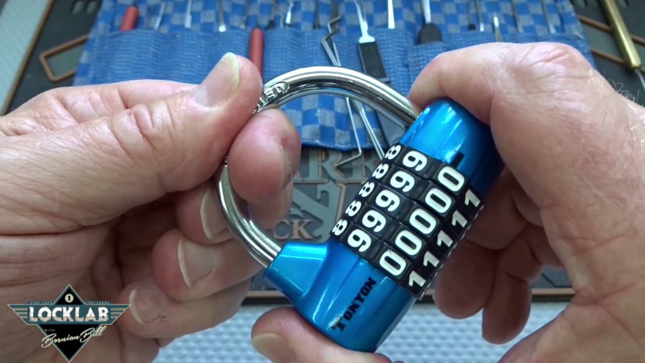

One human vulnerability I learned to opening these easily is that most people do not randomize all the wheels sufficiently when they lock them. Usually they just spin 1 wheel off from the open code by a few clicks.
It's often possible to open them by just spinning each wheel once, setting it back when it doesn't work and then repeating with the next. Often a quick flip of 3 steps in either direction around the center is enough to find the last changed wheel easily.
You can usually also eliminate 0's from the test few people use them and people have a bias towards starting with numbers in the middle of the wheel for some reason, as if lower numbers feel less secure.

Bosnianbill is great but to probe the gate you'll need a tool (or to make one out of wiper blades). Normally on combinations locks (those with a hasp) you can apply pressure pushing the shackle away from the body and working from the bottom of the cyclinder up rotate the dials until you feel a slight movement, at this point go onto the next dial. Not sure how well that'd work for a kensington lock but best of luck.

if you can secure the lock to something then you can pull the lock so the wheels lockup on the combo
