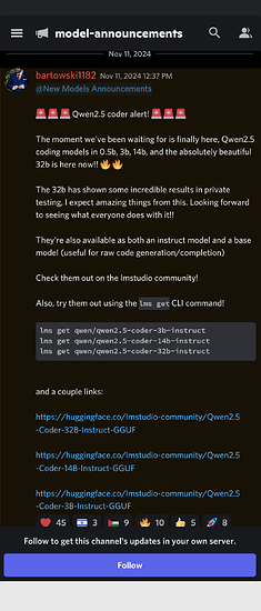

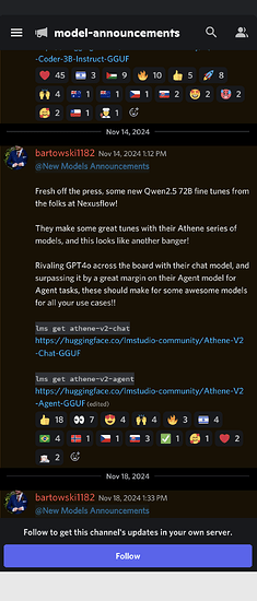

For coding, you might want to try out qwen, deepseek or any coding models in the lm studio discord
