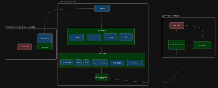

The program started out as a simple mongo db of pre-processed PDF’s that had been converted to MD. FIrst step was getting twilio/chatgpt/mongodb to all work together.
Twilio and chatgpt were easy. Their documentation and integration were great. I was able to get a docker container with a twilio endpoint up and running in no time hooked up to the chatgpt api endpoint.
After that it was introducing the program and logic for querying the mongodb. This required a fair amount of trial and error too get the chatbot logic to ask the right questions and use the query results for the correct context in the conversations.

  • The Fulltextsearch with ElasticSearch is very powerful. We are considering doing away with the MongoDB and just using the built in Fulltextsearch functionality natively with the LLM tool to recall MD files for context.
  • Proper Vector DB. Right now we are using MongoDB and search queries to provide MD strings that fit into the context window of chatgpt-4o-realtime. Next step is getting a proper vectordb to run alongside the traditional database to provide a smarter chatbot.

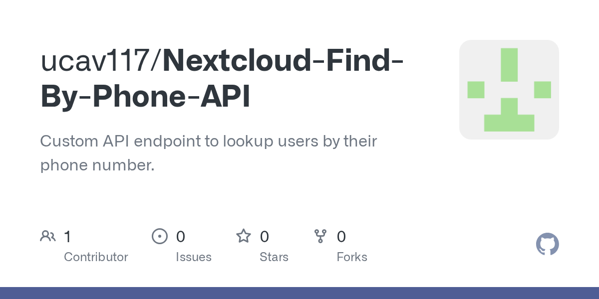

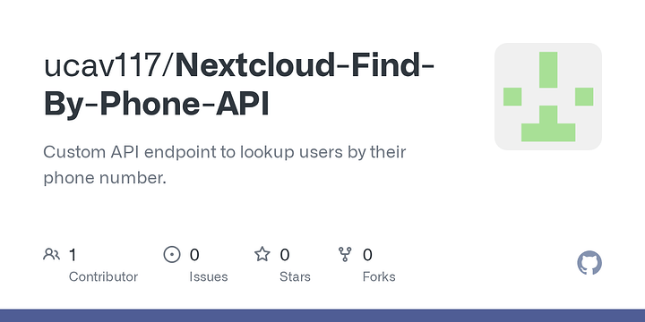

Created a custom API endpoint for Nextcloud to allow lookup of users based on phone number. We are using this to identify callers and initially allow/deny based on if they are a registered user in the nextcloud instance. IF they are a user then their information is passed to the LLM and python programs (Full Name, Email, etc.).
