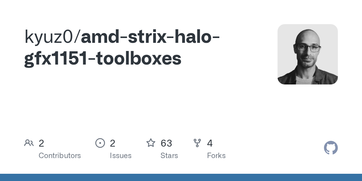

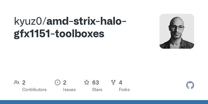

I am not sure what hardware you’re running, but I had similarly… strange behaviour off of a Strix Halo box I was using. I would constantly get responses like you describe. A reboot would often set it right again, but it seemed to happen more and more. I tried tweaking with all kinds of parameters to try to get it to improve but to no avail. I was also getting terminations at prompt fill. The model wouldn’t crash or OOM, but it would simply terminate during prefill and I thought it was some kind of timeout issue but my investigations there didn’t prove fruitful either.
I read about a lot of software stack issues with AMD and it opened my eyes to some of the challenges that are hidden underneath rocm. I eventually started applying a bunch of different vLLM patches for rocm to try to fix the issue. I got frustrated since I’m admittedly pretty impatient.
What ended up working for me was to migrate away from rocm entirely. I was able to get it stable for background agents by just using the vulkan-radv toolbox instead of rocm. The performance is roughly the same, and I don’t have any of these quirks to try to work out with rocm. If you’re on the same hardware platform and don’t want to mess around with custom patches to make it work, this is a path you could take. I’ll link the docker references and my startup parameters below:
llama-server
-m /models/Qwen3.8-27B-UD-Q4_K_M.gguf
–model-draft /models/MTP-mtp-Qwen3.8-27B-Q4_0.gguf
–spec-draft-n-max 3
-ngl 999 -fa on --no-mmap
-c 131072 -np 4 --kv-unified
–cache-type-k q8_0 --cache-type-v q8_0
-b 4096 -ub 1024 -t 16 -tb 32
–jinja
–host 127.0.0.1 --port 5800
