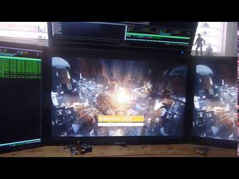

Hey Wendell, I would love for you to test this vs just using Parsec on the guest machine running headless. I have tested our latency and it adds only about 7ms on a local network for our entire pipeline, which judging by the video is less than what is displayed in your side by side video. Please note our client package is only available for Ubuntu (I’m trying to change that so we can get an Arch and Fedora build)
Here is an video where I do the testing. https://www.youtube.com/watch?v=dvGdNHx7alI (sorry it’s quite obnoxious)

The crossover monitor is slower than the dell monitor, by about 2 frames, and we’re experimenting with double buffering as a way of dealing with the desync that occurs between the “vsync” of the two different displays, which doesn’t help things. Not the visual aspect of it, but the time delay from copying a frame from the guest’s gpu to the hosts cpu, just the memory copy operation, is less than 1ms. It’s literally just the time that C takes for about 1 memcpySSE() operation on a buffer that’s about 10 megabytes big. Everything else is down DMA anyway, so technically doesn’t take that much in terms of cpu cycles.

Looks interesting but I can clearly see you are using YUV422 to reduce the bandwidth (color accuraccy suffers) and I would assume hardware compression, looks like NvFBC is in use here :slight_smile:
If that is the case, the FPS of the host and clien’t don’t relate like you would think as NvFBC will only present a frame to stream if a change has occurred, you could show the host running at 1000fps, but if nothing changed on screen, the actual network framerate is very, very low. The only thing it will help with is a drop in latency as there are more opportunities to display a frame when there is a new frame to show (And let’s not kid anyone, the video card is very good at providing a difference map at no extra cost)
Edit: Actually looking closer you are streaming at 60FPS, but the game is running with VSync disabled pumping out 240+ FPS, which is also why there is tearing going on. We can do this too but opt not to in favour of video quality as the tearing makes desktop usage horrendous. I’d love to see some footage of full screen motion (pan left/right) at 240FPS rather then just a partial screen update as is shown in your demo.
The latency that is visible in Wendell’s video is due to several factors, one of which he has already stated, simple monitor lag. There is some other issue with the code operating on the host AMD GPU, which is why I am trying to get some AMD hardware for testing.
On my test PC here the latency is extremely hard to see, around 90% of frames are delivered on time giving an average of < 5ms of latency, the other 10% are up to 16.7ms out due to clock drift between the two cards. If we were to operate at 240Hz I would expect an average of 1-2ms and a maximum of 4.2ms.

Yea I believe with Vsync enabled it would certainly not be as fast, I could enable vsync on client but it do believe we would run into the same slow downs you and Wendell are getting just due to the 16.7ms frame time.
The test we did went thru 60hz, 120hz and 240hz, the yellow frame counter is FRAPS on the client machine, so that is the received frames to client. If I was to move to the desktop, the frame rate to the client would drop to less than 20 - because as you said, we only send when there is new data.

Our slowdowns are not due to vsync, we are having a redraw problem on AMD host hardware to do with persistent ARB_GL_buffer_storage. We are actually completely synchronized, just not drawing properly (likely a buffer flush issue), you can actually see this in the video where the blue square seems to tear and jump backwards, and this is with vsync. Once I get an AMD GPU I will be able to diagnose this.

@jamesstringerparsec Here is a demonstration of the setup when things are working properly :slight_smile:
