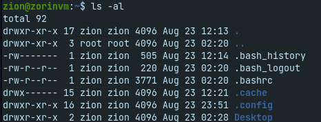

Thanks high, but i wasnt able to find that file, unless Im suppose to generate it myself and add all that text. Here’s my search for the file and/or directory. The second to last looks sort of like the path but obv very different. Be gentle Im new to Linux
The linked input.conf is just the default values that you get without specifying your own configuration. You just need to add ~/.config/mpv/input.conf and put in the 2 lines that he mentioned. Since it seems you are new to Linux, this is basically the defacto way to configure your users settings.

Ah ok, the . or dot threw me off, thanks for clarifying, In case anyone is reading you can cd or change directory then do a ls -al to get it to show.
I dont see however, the mpv directory, am I suppose to create this or…?
