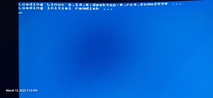

It doesn’t boot up at all with the 9070 after installing it …figured it would just work after I updated, but nope. It gets stuck on “initializing ramdisk…” and nothing happens, I waited 10minutes. I tried Garuda(a gaming version of Arch) and it booted without issue and that one was on an older Kernel than 6.13(6.12 or something and then I ran an update and it went to 6.13) …
I made a bootable USB of OpenMandriva which was on Kernel 6.13, that never booted either, that one just gave me a blank screen…
The screenshot is what happens if I try a normal OpenMandriva boot and it will sit there until the end of time and not boot.

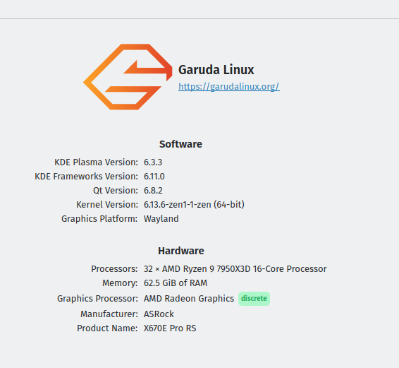

Garuda was booting but it wasn’t showing the GPU and games wouldn’t play so that was fixed with re-installing a bunch of stuff(basically throwing things at the wall until something stuck…lol).

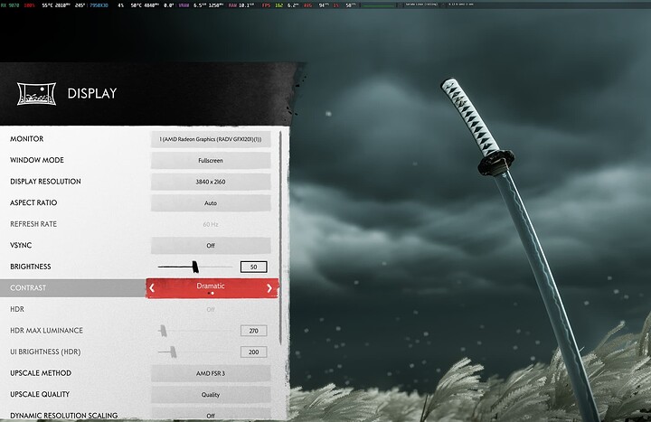

That seems to have resolved the issue, the GPU shows up now, it detects the card as gfx1201 though whatever that means…but the clocks and power and memory all appear correct.
So I guess I will be using Garuda for a while again, since the few games I tried all work fine.
