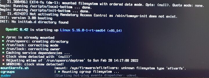

Corrupted Linux installation due to memory error(s). System is booting up till the lukscrypt containing the installation is opened. After this there is a lot: rcu: INFO: rcu_preempt detected stalls on CPUs/tasks:
Then the process hangs on various stages never reaching shell or xsession.
