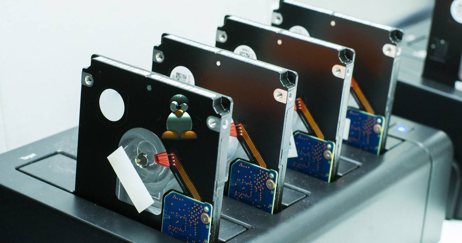

When I’m doing this sort of stuff I make use of the ancient (up to 9 year old) SSDs that I have lying around, and just clone the whole SSD to another (same size or larger) SSD.
You can do it in software:
…or you can get yourself a drive dock that supports cloning. I use an ORICO 2.5 / 3.5 inch 2 Bay USB3.0 1 to 1 Clone Hard Drive Dock that I picked up years ago. Can’t say it’s particularly fast, but in my mind you can’t beat:
  1. plug in source drive
  2. wait a few seconds
  3. plug in destination drive
  4. wait a few seconds
  5. press the clone button
  6. walk away
No host computer or software required.
I realise that you’re doing this on a laptop (or whatever the heck a Lenovo IdeaPad S405 is), so dock-based cloning might not be practical. I mention it more for the benefit of others that might come across this thread and have more easily-accessible drives.
NB: The above is not a recommendation for the Orico dock. At the time of purchase (quite a few years ago) I was in a hurry and it was all I could source locally at the time. I’ve never used the 3.5" slots and it took a while to learn the dock’s ‘quirks’. It has, however, cloned flawlessly for years. If I was in the market for a new one I’d get a smaller unit that just has two 2.5" slots and stand-alone cloning — that’s a must as far as I’m concerned.
