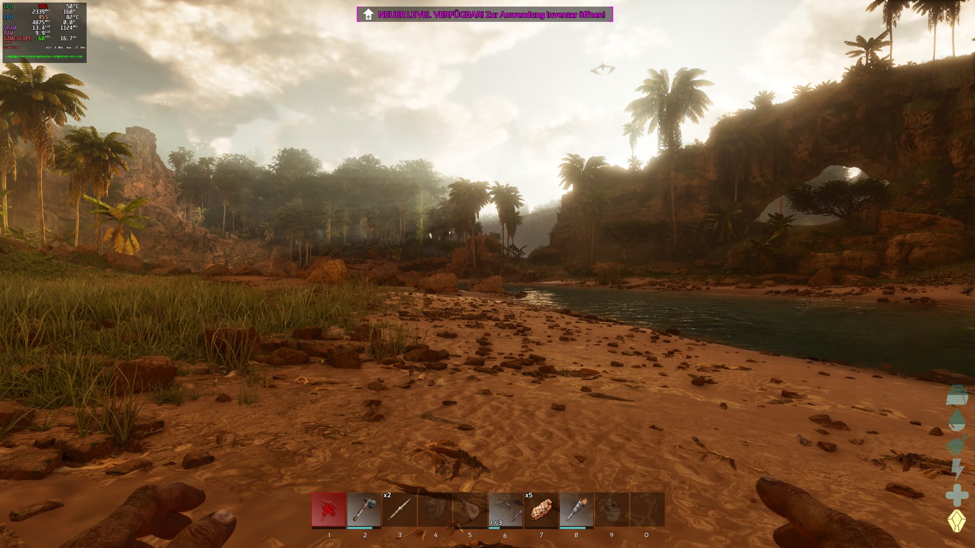

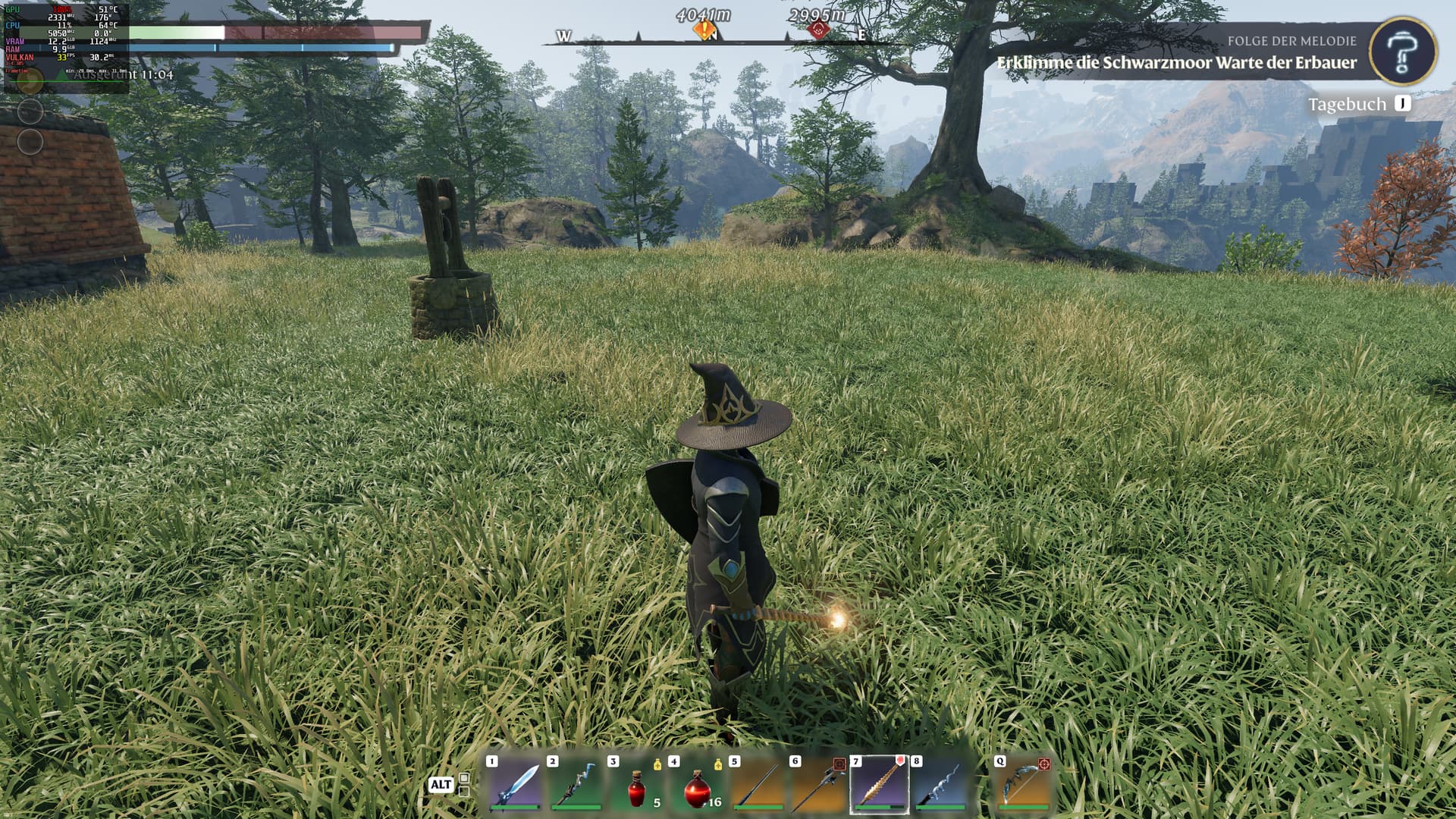

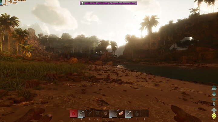

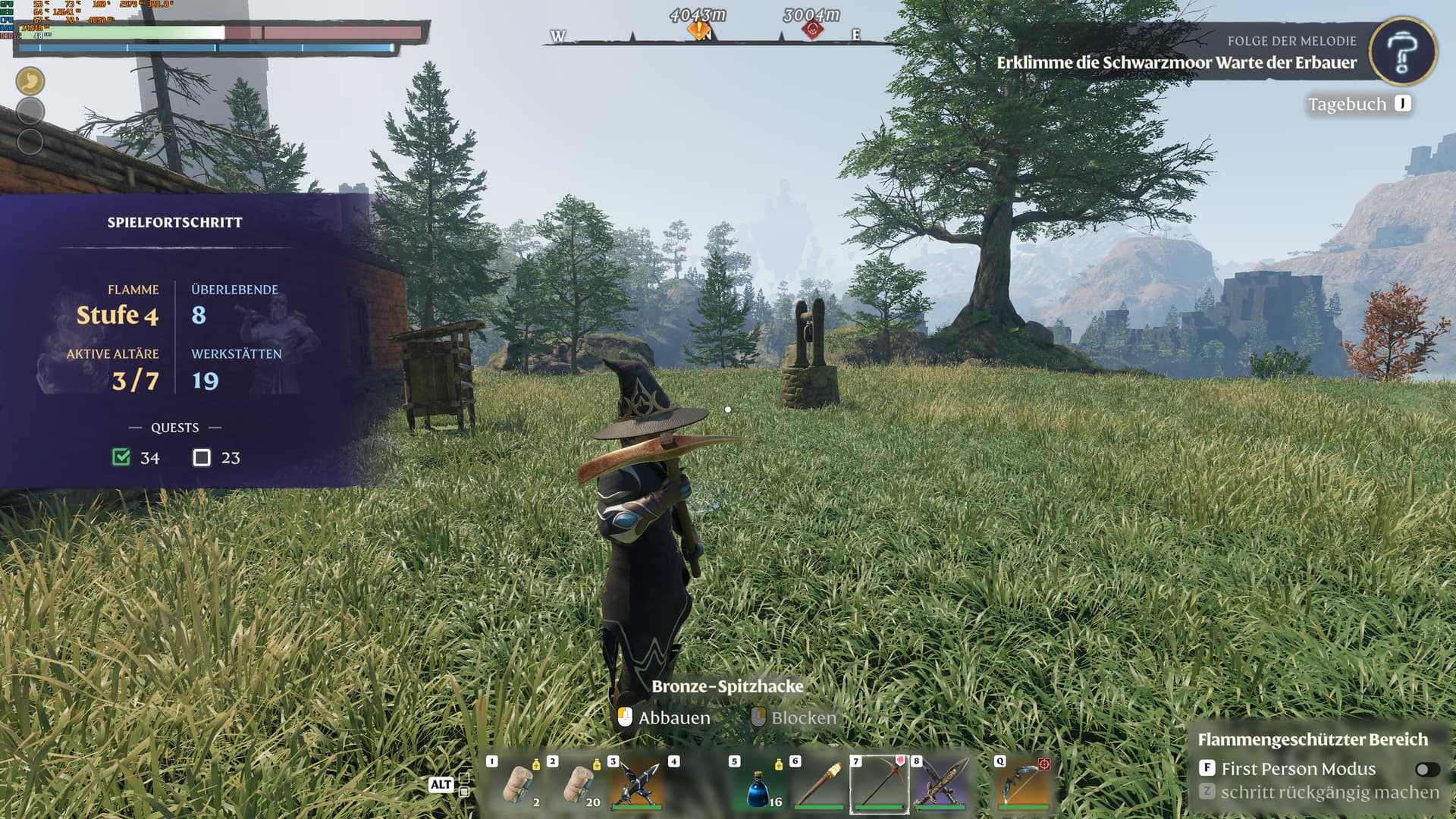

I have a problem with Arch Linux. The Graphics Card is being underutilized like around 200W with just around 2400 MHZ. But in Windows its using almost 304W (so the full potential) I am using the latest Mangohud with Proton-GE 9-27. It must some software bug as it is fine in WIndows.

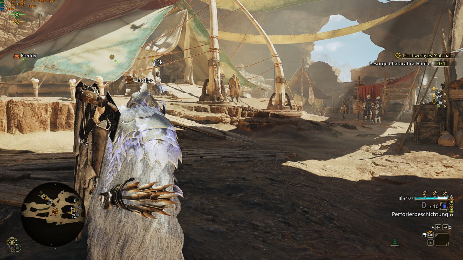

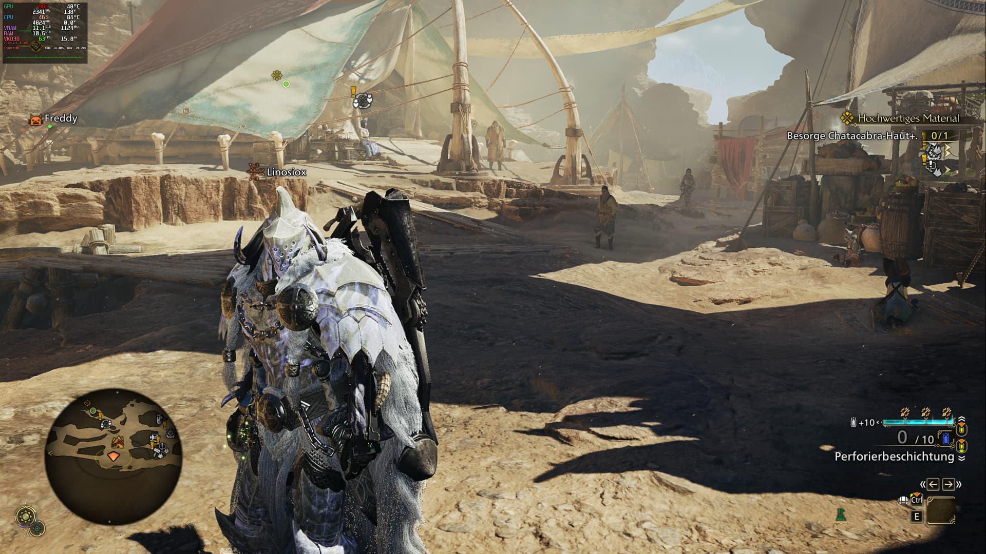

Looking at the screenshots you provided, one scene has way higher CPU-util than the other. The second secreenshot has CPU-load so high, it backed off from maximum boost.
Is the framerate the same for this?
As in, is every setting in the game the same leaving only the OS as a variable?
For Monster Hunter Wilds the performance is roughly the same i think or i might be wrong. But for the other games (Enshrouded, ARK: SA it’s not really the same) I don’t have any references so it could be also WINE but I am not quite sure. But you can see the power and Frequency utilisation is near 304W or more near it)
Part 2 because i can only post pics at a time
Anyone an idea why this happens? :confused: I am just irritated why it does that. I guess the drivers are still too fresh or something.

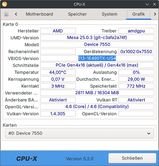

Thanks, yeah i am using mesa and i am using the latest firmware on Archlinux I will try these kernel parameters to see if it’s making a difference. I will try using amdvlk again lets see.

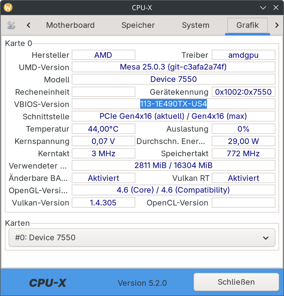

So I tried the kernel parameters as aswell as AMDVLK. No difference there. :frowning: What I wonder is why my BIOS version is slightly different from that on TechPowerUps bios collection.
The version currently certified on TechPowerUp ends with US3, but I don’t really know what could be that different from that version (mine ends with US4).
