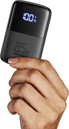

I’d honestly recommend getting something like a standard power bank. Anker makes decent stuff. The amount of work/effort to make the a battery with a circuit board will probably not be worth the effort.

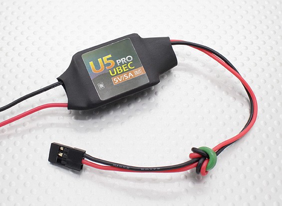

Probably a drone battery. They’re just the cells and as little plastic as needed to hold them together because drones are all about being small and light. They come in a pretty wide range of sizes and cell configurations.
You can pair it with a little switch-mode regulator to get 5v power.

To achieve the highest power for the space you take up, you need to go pouch cells, which means nonstandard. I saw you mentioned that you would like built in goodies to make these not blow up, so I would suggest simply buying a cheap battery pack from a reputable company that uses pouch cells.
If you are 3-d printing a case then you can just add a slot/space for the battery bank. It’ll make it a little more bulky. But it allows you to have everything all-in-one and you can easily use the power bank for other purposes when the router isn’t in use/needed. Also makes it easier to maintain the health of the battery pack.

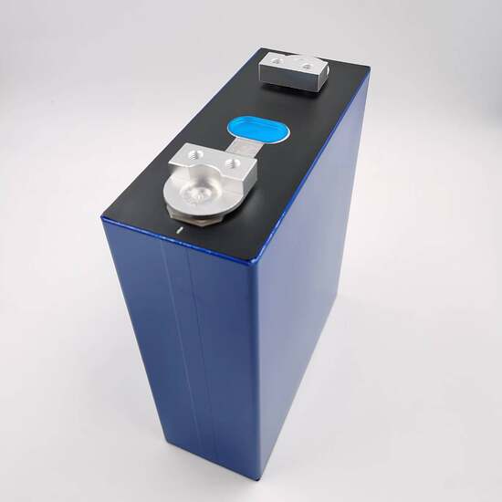

or get a single dense battery cell that will last a while, then boost the output to what you need. This battery cell should last you a while at 314AH.
Yeah, and it can also melt a wrench placed between the terminals. :joy:
EVE also manufactures 50 and 30Ah(?) prismatic cells. One of those would be much more reasonable than lugging around a brick-sized battery with you.
Although, if the OP wants to travel via airline, you need to consider the maximum legal capacity.
For LFP it’s: 100Wh / 3.2V = ~31Ah,
and for traditional Li-Ion it’s: 100Wh / 3.7V = ~27Ah.
You’d also want to add a battery protection circuit to prevent “oopsies” from happening. :smiley:
