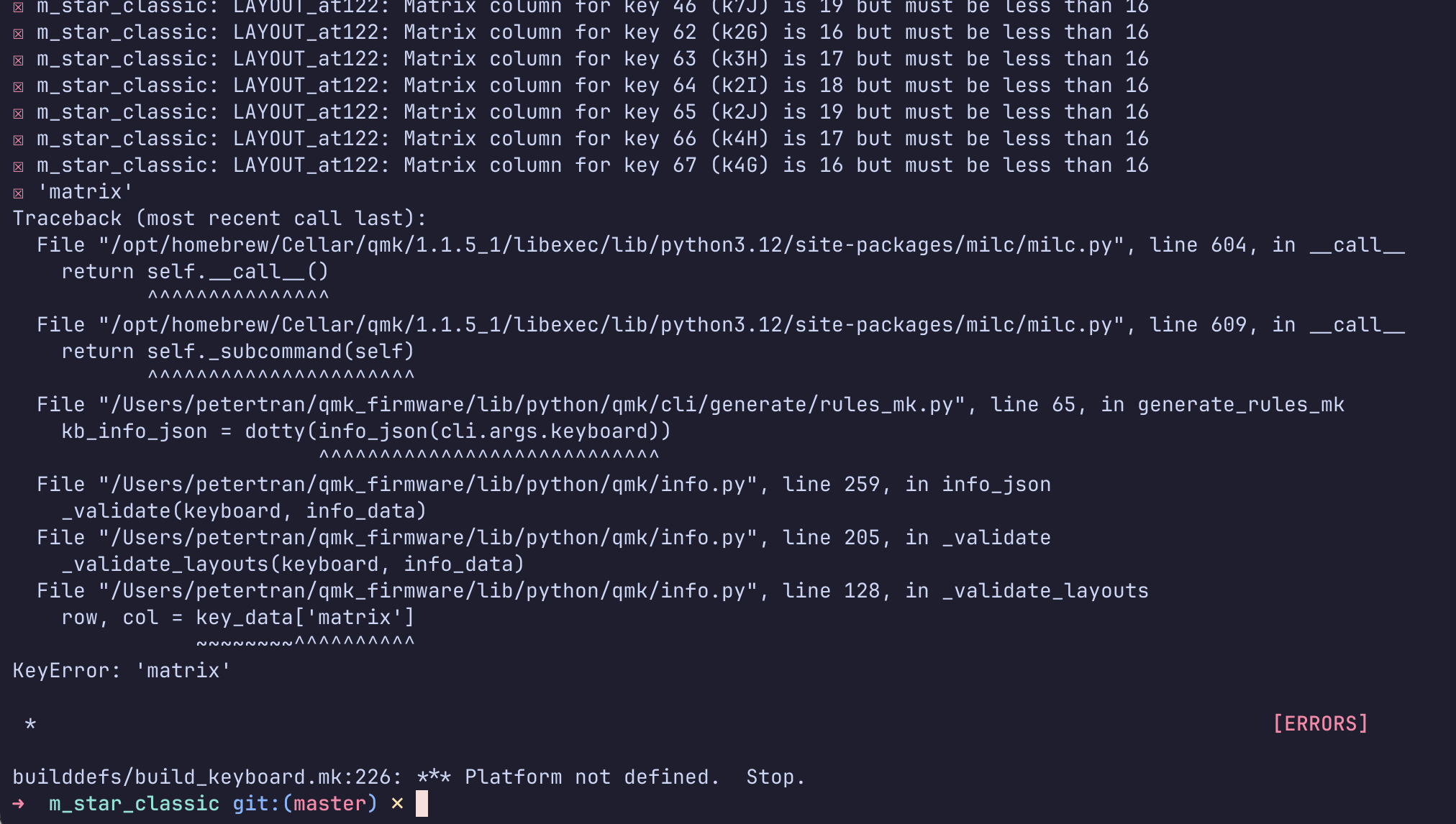

Having followed the How-To Guide from @Level1_Amber as well as the QMK Tutorial, I attempted to flash Wendell’s layout onto my new M-Star controller in my new Mini M and ran into significant trouble, though I suspect that it is something quite simple that I am missing - like the wrong files a missing command argument, something like that.
The screenshot below shows the errors I get when I attempt the QMK Flash command (attempting the “minim” keymap first). Also, it wasn’t exactly clear from Eric Raymond’s gitlab where to find the correct source files because some of his documentation references /QMK/m_star-mini but there is no such directory in the repo, but there is an m_star_classic, which seems incorrect or confusing.
