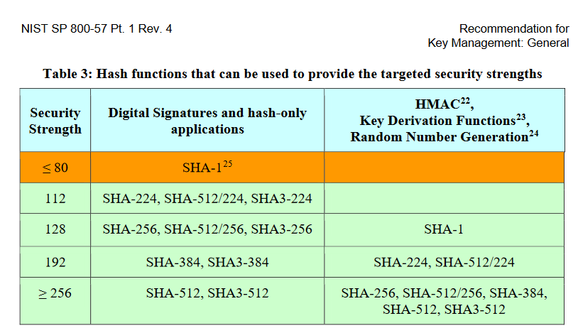

Since you brought up the National Institute of Standards and Technology, lets see what they say.
NIST Special Publication 800-131A Revision 2
Transitioning the Use of Cryptographic Algorithms and Key Lengths
by Elaine Barker and Allen Roginsky
Published March 2019
Chapter 9 Hashing Functions
A hash function is used to produce a condensed representation of its input, taking an input of arbitrary length and outputting a value with a predetermined length. Hash functions are used in the generation and verification of digital signatures, for key derivation, for random number generation, in the computation of message authentication codes and for hash-only applications.
SHA-1 for digital signature generation:
SHA-1 may only be used for digital signature generation where specifically allowed by NIST protocol-specific guidance. For all other applications, SHA-1 is disallowed for digital signature generation.
SHA-1 for digital signature verification:
When used for digital signature verification, SHA-1 is allowed for legacy use.
SHA-1 for non-digital signature applications:
For non-digital-signature applications, the use of SHA-1 is acceptable for applications that do not require collision resistance.
SHA-224, SHA-256, SHA-384, SHA-512, SHA-512/224, and SHA-512/256:
The use of these hash functions is acceptable for all hash function applications.
SHA3-224, SHA3-256, SHA3-384, and SHA3-512:

For sure, our clients require ALL network traffic be encrypted. We have an eye on the coming FIPS standards which will deprecate SHA-1 and like stated:
So SHA-256 is the minimum with the new NIST proposals at the levels we have to achieve, as a result we have clusters of MikroTik 32 core routers running environments with 60 workstations to achieve simultaneous sustained 1 gb throughput. For reference, this same hardware could EASILY support 3000-4000 users without the authentication and encryption requirements.
