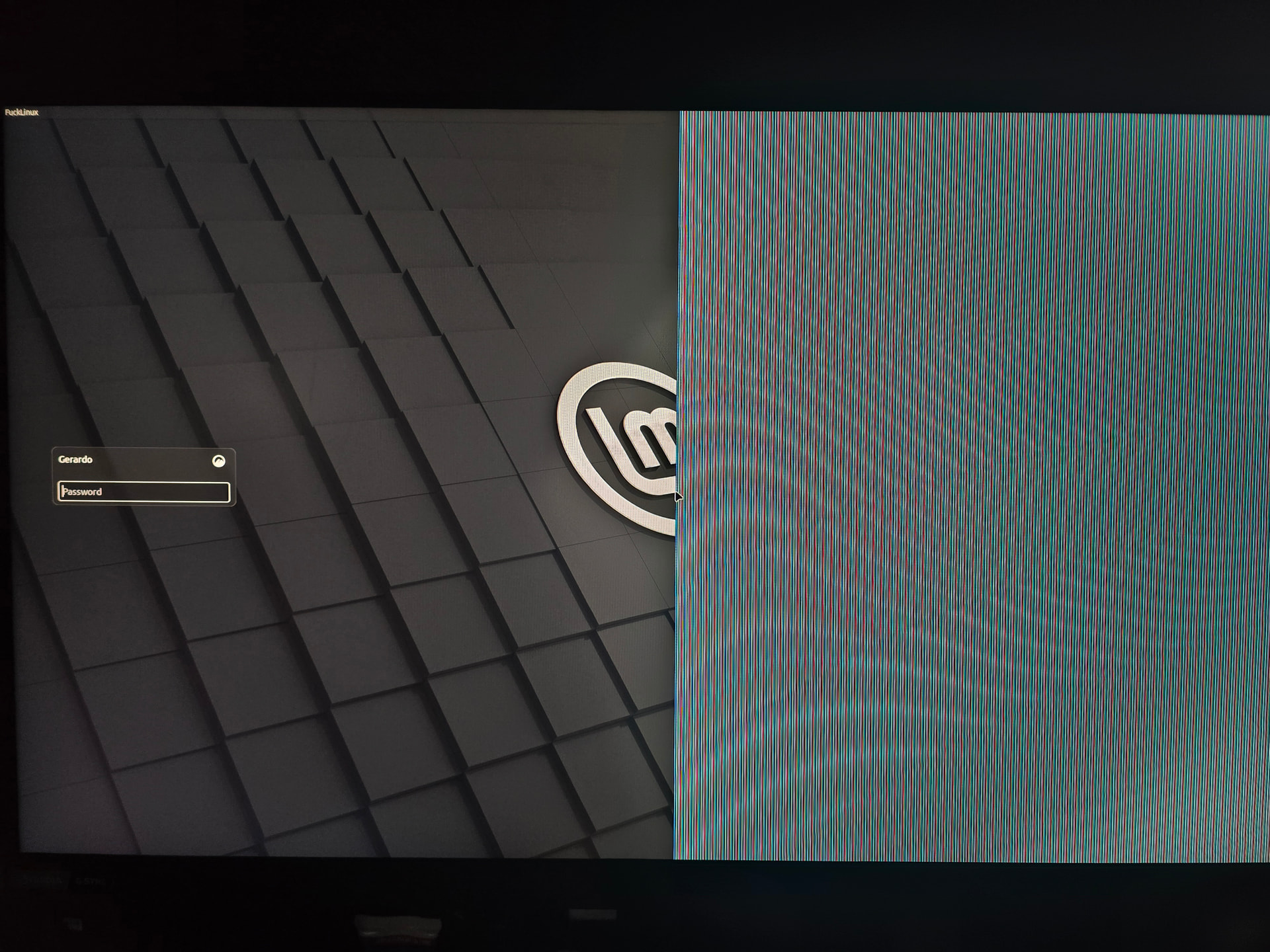

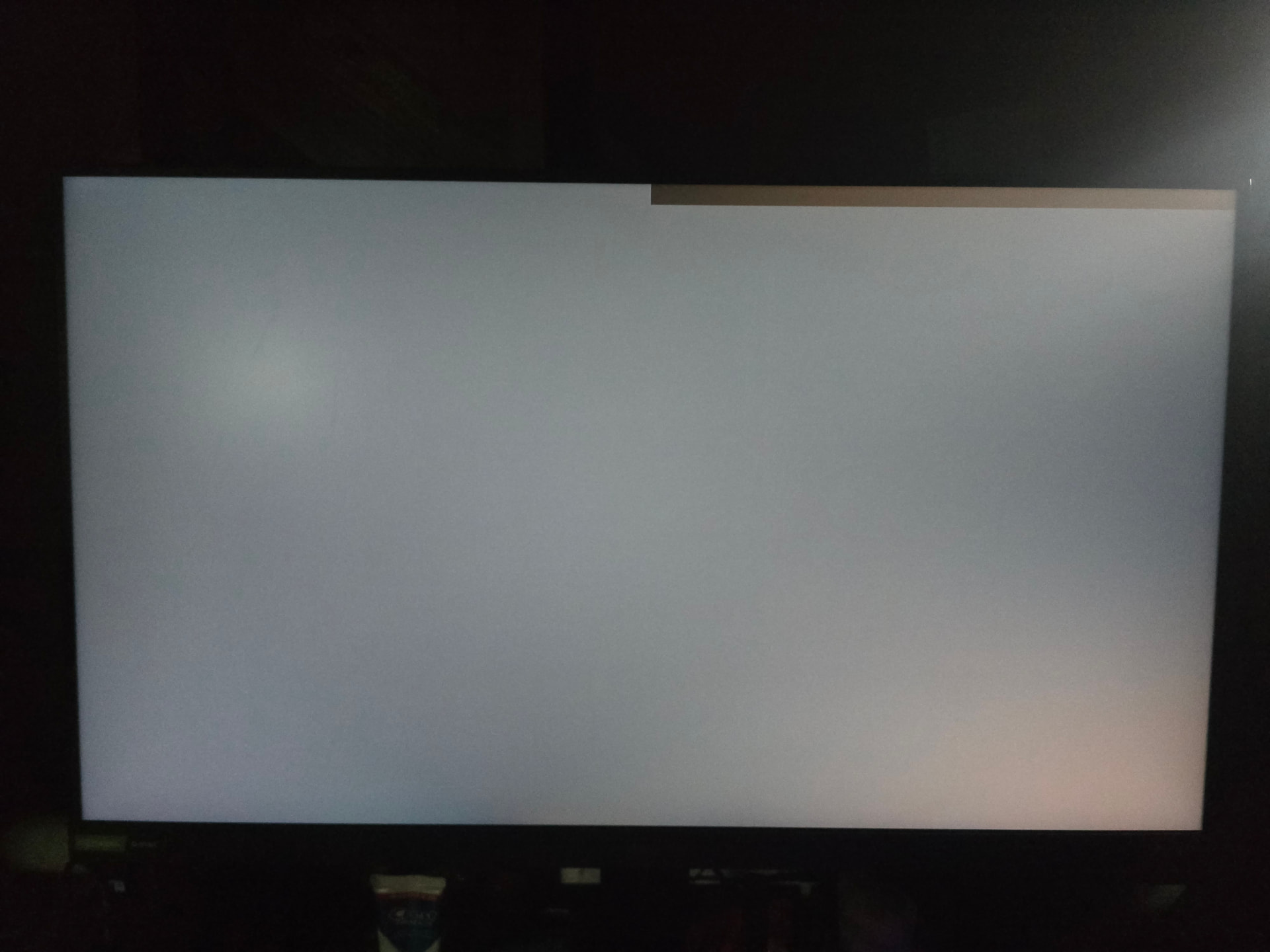

So just 5 minutes ago, I noticed on the Update Manager on Mint that there was one for Linux header and I think a kernel one (didn’t really pay TOO much attention). Now my BIOS post page and the GRUB look fine but as soon as I get into Mint, the screen is half black or with stripes and then immediately goes gray with a black bar on top and I can’t do anything on it. How do I fix this? :weary_face:
For more detail, I recently (like 2 weeks ago) installed ROCm 7.14.0 (yes, I deleted the old ROCm stack) and the new MESA update from a couple of days ago so Idk if that’s messing with the new update. It’s all been working fine until the update I made this morning.

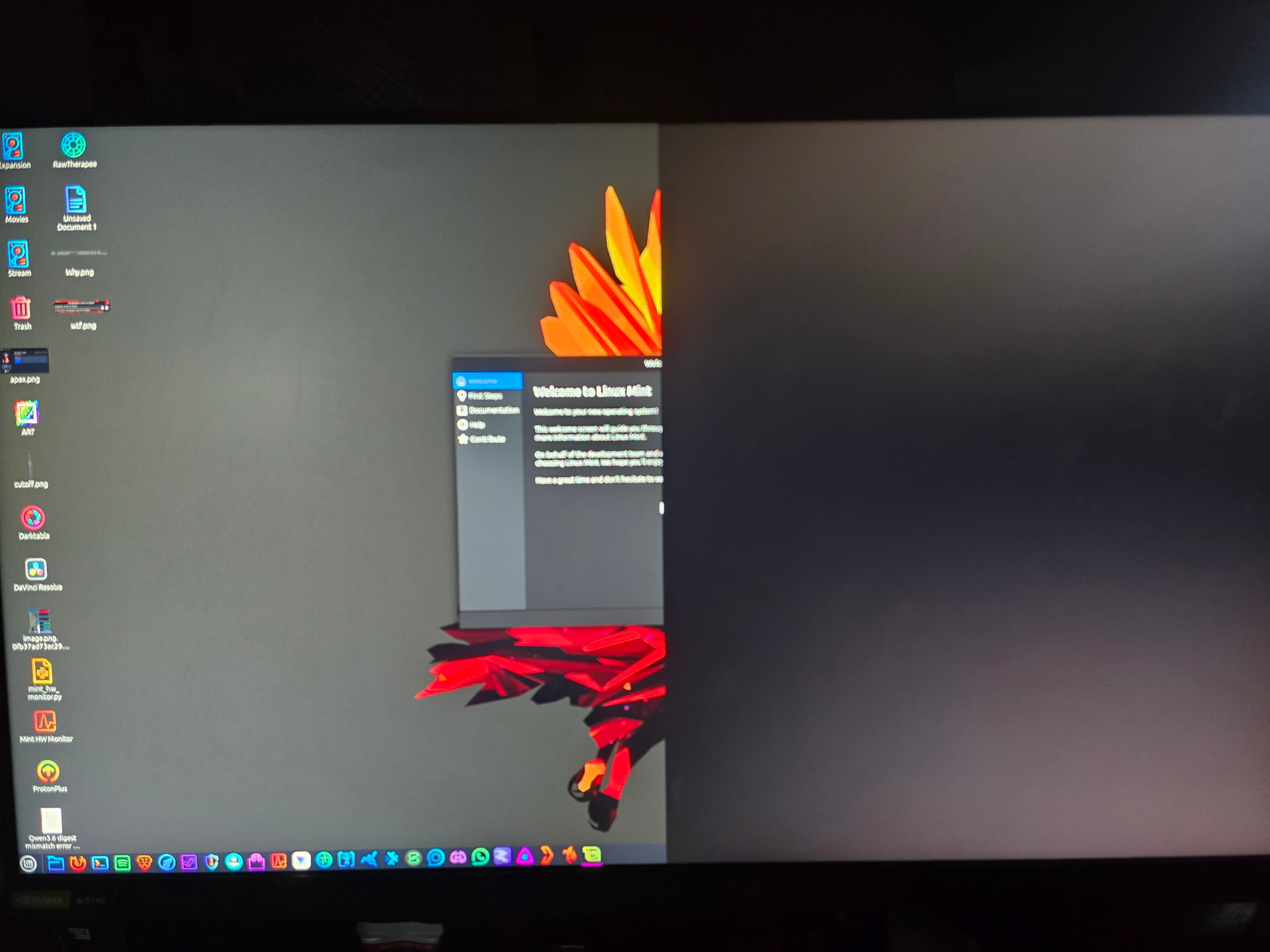

Def related, the 2.29 firmware is the cause of it. Was able to revert back to 2.26 and my computer’s working fine now (actually writing this from it). Reinstalled 2.29 out of curiosity and the half black screen came back immediately. Also found this thread on the Mint forums of people having the exact same problem I did: https://forums.linuxmint.com/viewtopic.php?t=472692.
