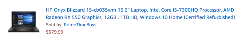

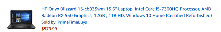

Almost, as if by serendipity, Amazon provides an answer:
As of the time of writing this, you can buy this very model of laptop for approximately the same price new. Back in late 2017, this was around $200 dollars off from online retailers, and perhaps double that if you walked into a local shop. After just a brief amount of research, I clicked the purchase button - and I am not sure what to write after this statement. Part of me wants to say that I spilled coffee on the wrong laptop. Another part of me is glad I got a good deal on so many learning opportunities, which you will note is a very sideways compliment.
To begin, this is a 15.6" laptop hobbled together by HP. A “Power Pavillion,” which basically means they wanted to appeal to the growing market segment of light gaming and productivity paired with mobility, and didn’t want to sully their other branding with a product that didn’t necessarily match that style or quality. Hence “Power Pavillion” - because trying to pass it off along with their “Envy” line would be weird, and there are limits to what they’ll stamp their “Omen” branding on. It’s not like other Pavilion products either, so, we better make those marketing guys earn their paycheck. I bought it because I felt it would be perfect to experiment with, and boy was I right.
