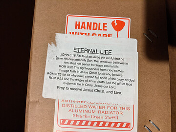

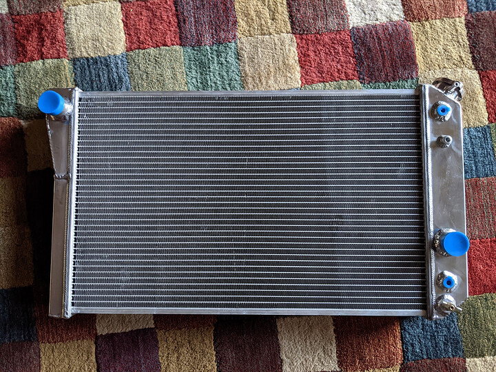

It has arrived.
Even came with a prayer on the box, not sure if thats a good thing.
