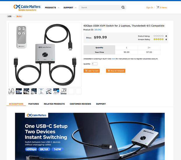

G’day from the land down under. Long time listener first time caller. Hi @wendell love your work mate​:waving_hand:
Apologies for reviving this necro thread.
Looks like Cable Matters has listened and very recently answered a need we’ve had for years.
I just need to share my kensington TB dock between work laptop and home desktop.
