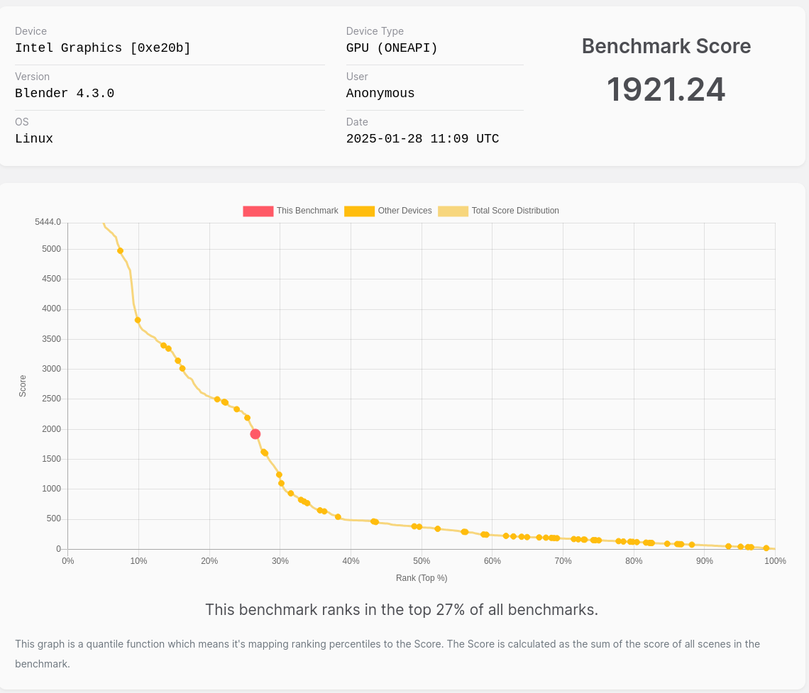

For anyone interested in Blender Performance on Linux, using the newest compute-runtime release compiled from github (24.52.32224.5) on Fedora 41 with Kernel 6.12.9-200 I achieve:
I think that’s a nice little improvement but definitely still leaving performance on the table.
do you have an idea of where it was before the driver update? and how it compares to say the a770?
The A770 achieves roughly 2100 pts on Linux.
My B580 (Limited Edition at default TDP) was at around 1800 points before.
I could probably achieve better performance raising the TDP to 200 (not sure if higher is possible) and with some additional system tuning.

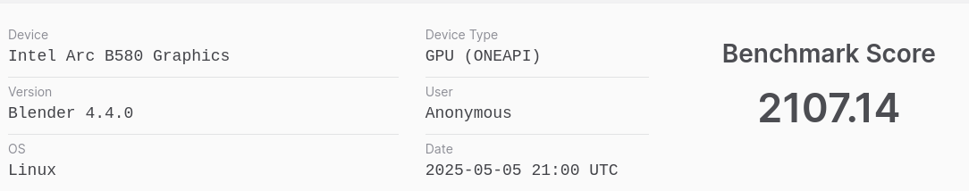

On the newest Blender and intel-compute-runtime versions I’m getting better performance than A770 and close to an RTX 3060.
