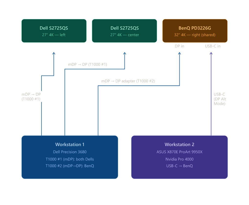

Scenario 1: Current workstation setup is workstation 1, just added workstation 2. Since workstation 1 has dual gpu’s, would it be possible to just switch the 32” BenQ between the two workstations but keep the 27” Dell’s on all the time via something like Mouse Without Borders? Workstation 1 would be in control of the two 27” Dells at all times. The BenQ would reflect Workstation 1 or 2 depending.
Scenario 2: Just have all three switch based on the workstation.

Disregard for now. I bought the BenQ for it’s built in KVM and I think I had some wiring wrong and it wasn’t working. I have a cable on the way but I’m optimistic it’ll work.
Did your cable work?
Yes it worked. I’m using the kvm wireless puck to switch the main monitor and the new powertoys monitor switch for the other two monitors. Not one button convenience but it works. Thanks for checking. :blush:
