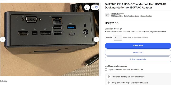

Other thing to consider. USB C alt mode DP, and a DP MST hub.
And if it’s a thunderbolt USB C port, there are dirt cheap used OEM hubs that have multiple DP ports.
One is a miniDP, but that’s a passive pin-to-pin conversion.
