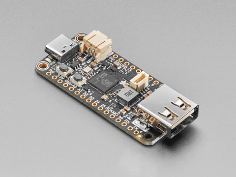

Thank you for providing more detail. Since there is no custom firmware available yet, will this work as an inbetween? Adafruit Feather RP2040 with USB Type A Host
