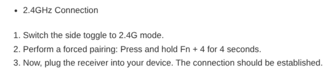

No amount of resetting it in funny orders did anything, but the official re-link procedure did:
This fixed it.
