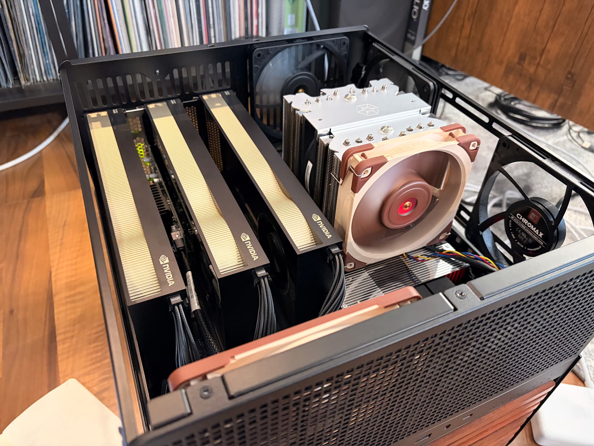

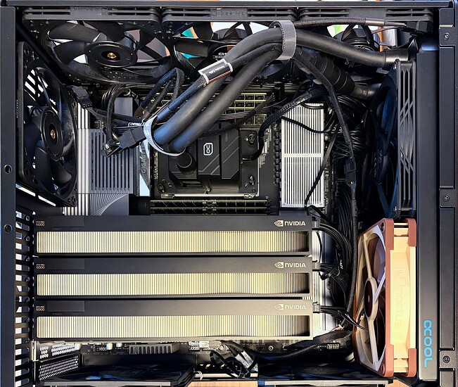

An in-progress snapshot of this multi-user CUDA workstation build. This is based on the Threadripper Pro platform, running in an AI TOP motherboard, a bunch of storage, and three RTX Pro 6000 MaxQ GPUs.
The purpose of this node is to be a host for multiple CUDA devs, who connect via VS Code Remote to the node, and then work within GPU-enabled Dev Containers (Docker) on various projects. Can’t go into too much detail, but the work does not involve LLMs, it’s mainly focused on signal processing (mostly audio), video, and generative 3D graphics / world models. Devs might spin up live experiments, allowing test users to dial into the node from display clients (e.g. VR headsets) and interact with the experiment, off-loading the computation to this node. An experiment might require a dozen or more distinct models (or other CUDA-accelerated processing staged) to run, and a scheduler allocates these to the available GPUs, streaming them from NVMe storage or a ramdisk as needed.

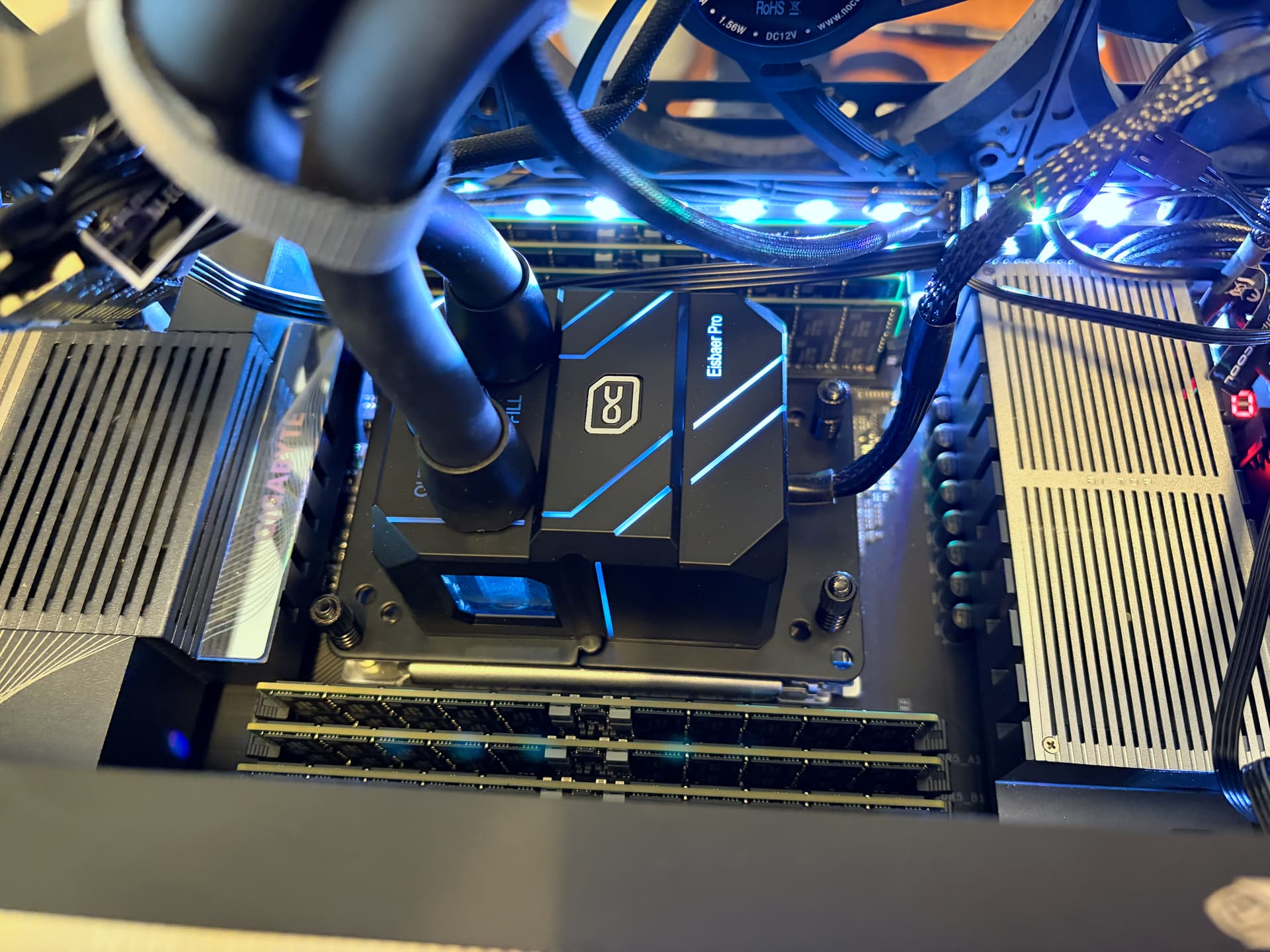

Some pictures (more details on the parts below):

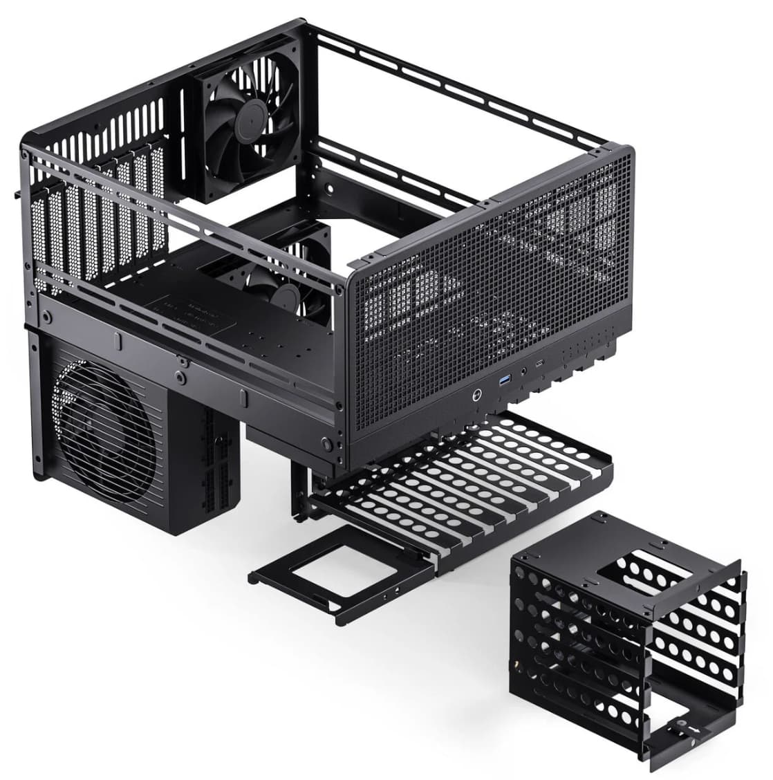

Case: Jonsbo N5
Space is a concern, and this case offers good density and airflow, with plenty of storage mounts. But overall, the case is disappointing on several fronts for a build like this (EEB-ish motherboard, fully loaded)
  • Jonsbo uses no less than 5 different types of screws for this case. While some can be replaced with “standard” thumb screws, others can’t. Phillips (three sizes), special shortened PH00 (radiator cover front), hex (the lid), etc. - it’s a nightmare to keep track of these.

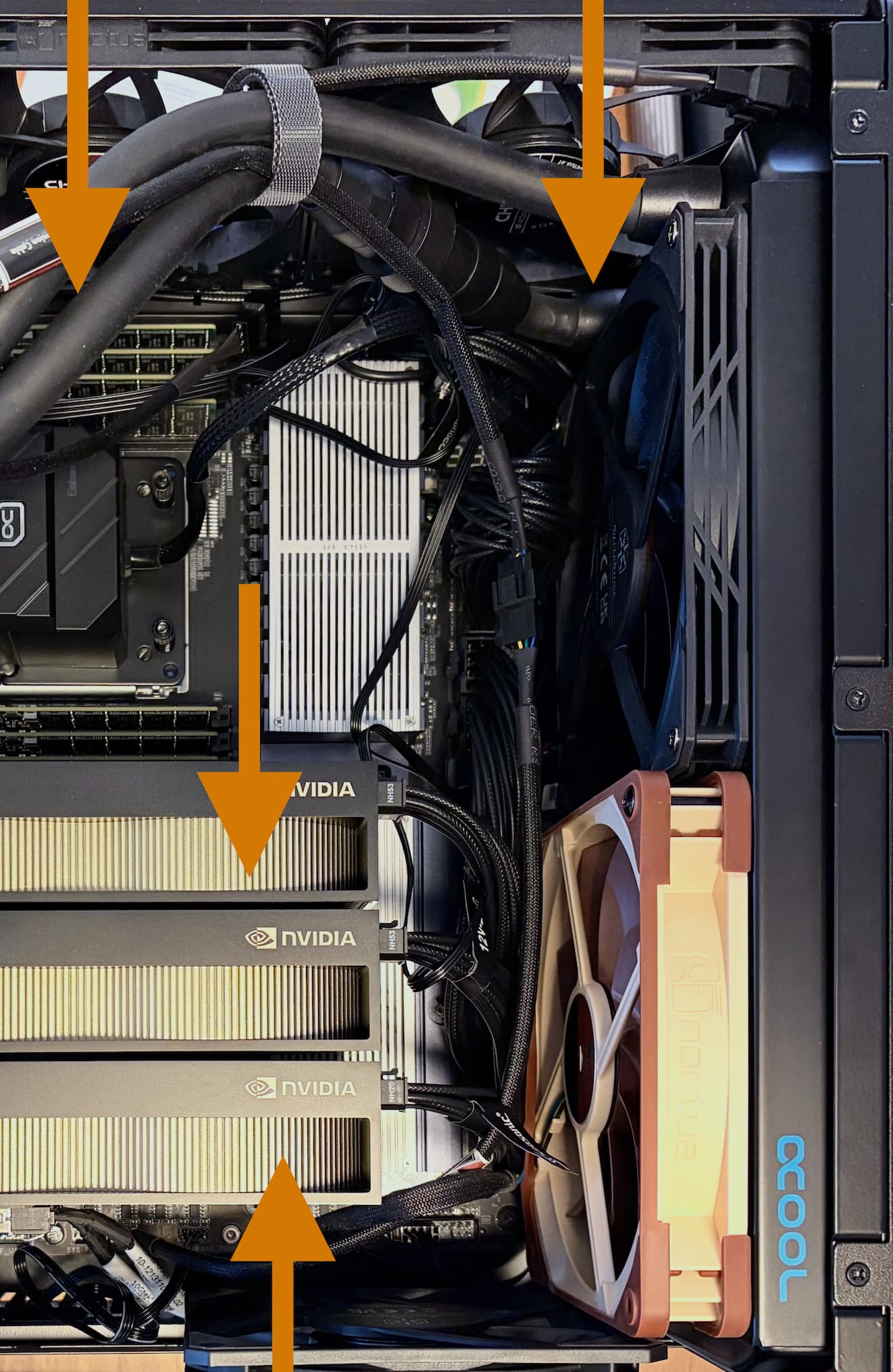

  • The case is inexplicibly excactly 8mm too short for a 360 rad to fit on either side. The motherboard clearance, mounting holes, etc. all line up nicely for a 360 AIO, the only limiting factor is case length/depth. This led to the switch from the SilverStone 360 AIO we used previously to the Eisbär Pro 280

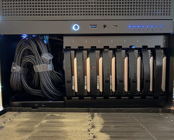

  • For a decently long PSU, the left front drive cage on the lower level has to be removed. Instead, we added an aftermarket metal 4x2.5" SSD cage behind the 8 other bays. This left bay also wouldn’t have any HDD LEDs even if left in. Removing this drive cage to make enough space for this PSU also means the front lower-level cover doesn’t close on the left side, as it is only held on with magnets, and that magnet in turn attaches to the drive cage.
  • The HDD backplane fan power connectors Jonsbo supplies are fixed at 100% fan speed (3 pin only). They’re unusable.

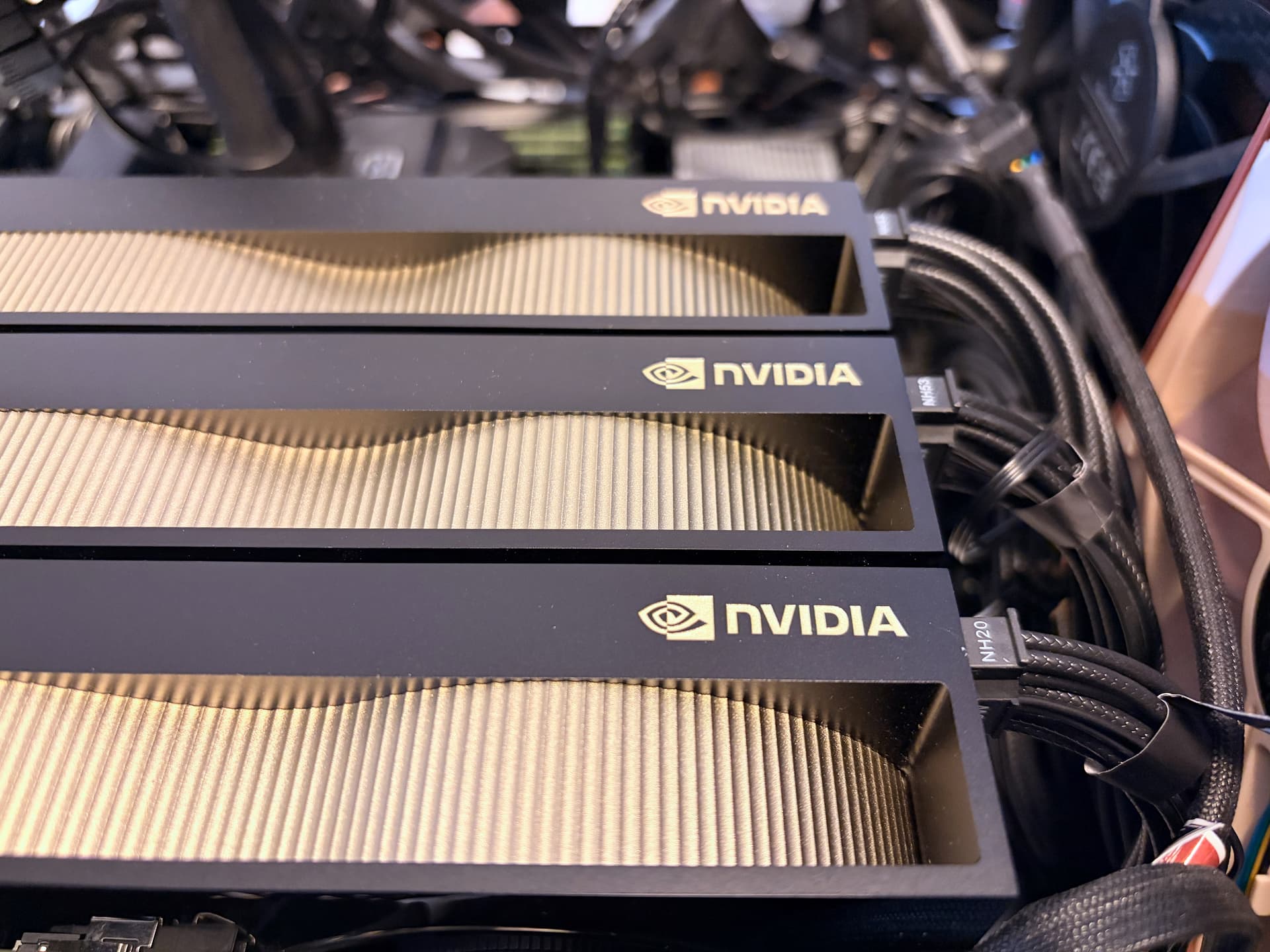

  • Worst of all for blower-style GPUs (like ours): the PCIe slot dividers Jonsbo uses block 1/5 of the airflow path. They’re too wide. I’ve never seen this before. We will snip these during the next cleaning check.
We made it work, but it did take a lot of time and effort. For a v2 of the N5 I’d love to see Jonsbo going for more standard components.
On the positive side, the case has an enormous void behind the HDD bays - lots of room for activities! We mounted more SSDs here, but there’s enough space for e.g. a full-size KVM, more HDDs, and plenty of other stuff.

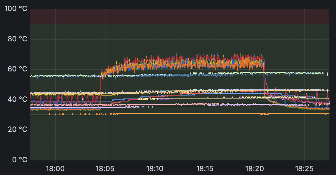

CPU temps (top lines) under full load (mixed StressNG + RAM):
The blue/green middle lines are from sensors near the “hot” M.2 slot. If you’re wondering what the effect of the airflow path on GPU temps is - with the AIO venting “into” the case - the hottest GPU only gets 4C hotter when the CPU is fully loaded.

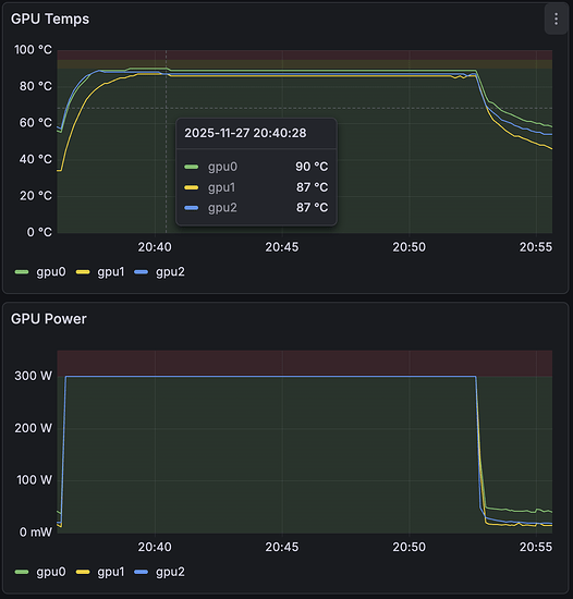

Which is a moot point because NVIDIA disabled fan control on these cards, and the built-in fan curve waits a long time to ramp up. Cards will hit ~90C immediately under load, with the fans sitting at 50% for minutes until they kick in. But that’s fine, the MaxQs only throttle at 95C or higher, so the base clock speed is maintained. Careful though, these are blower cards: there’s a minimum of 60cm of free space required at the back of the case, and no cables must cross the exhausts. These cards truly become hairdryers under load. That’s why Jonsbo’s insane PCIe dividers are also an issue.

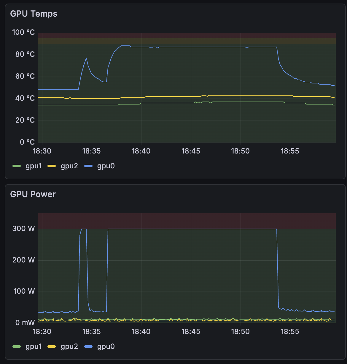

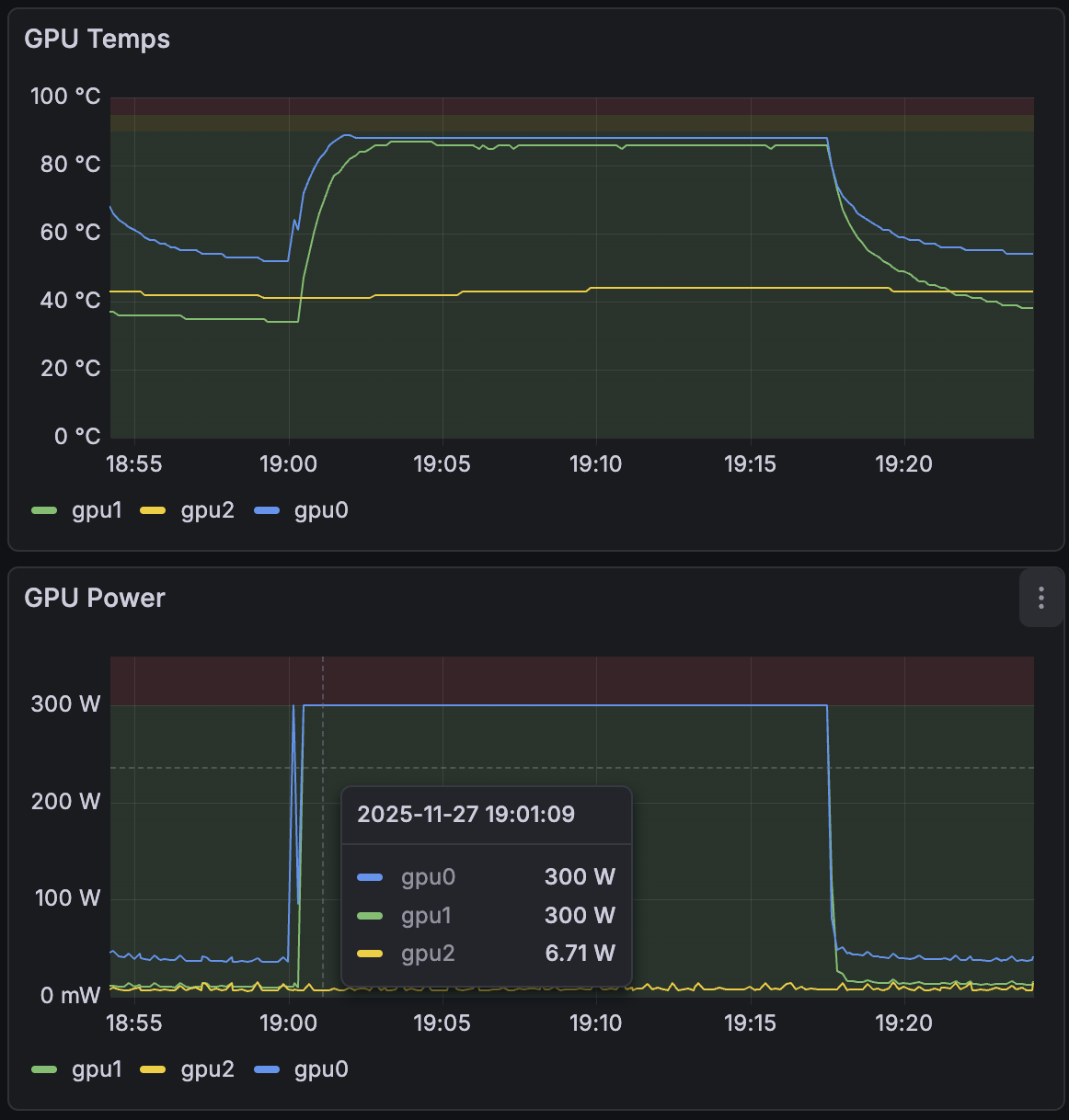

Here are some burn-in tests: 1 GPU, 2, 3:

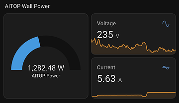

The system has its own circuit, and this is the wall power draw with all three at full utilization:

Maybe you already tried it, but it might be better to put the AIO in the top of the case. (and maybe make it an outtake). this way the gpu’s are pulling in cool air instead of getting hot air straight from the AIO. There are intakes in the bottom, but the air from the bottom noctua fan is going to clash with the bottom intakes.
In a real custom solution I would duct a high presure fan to the 2 top gpu’s so that the blower style fan doesn’t have to work as hard.
There is no top as such - maybe the perspective is misleading. The board sits horizontally in the case, in the first picture you’re looking at the system top-down. There’s just a lid that goes over the top.
I did multiple experiments to verify exactly this behavior - the AIO air does not significantly affect GPU temps. The GPUs get their air from each side of the GPU stack, where fans deliver fresh air directly from outside the case (left and right). That airflow far exceeds the air coming from the AIO :slight_smile:
The air from the Noctua AIO fan actually just runs into the closed back of the GPUs, and vents through the perforated lid immediately.
Edit: if by top you meant what is the “right” side - that’s what I was talking about in the original post. I wanted to mount a 360 rad here which I had been using with the same CPU. But the case is too short. So it could only be a 240 rad, which isn’t enough cooling (or cutting it very close at least). The case is designed for a front 280, so I went with that.
Eventually, the ASUS board is going to allow 1 slot spacing between the GPUs, eliminating all airflow restrictions.

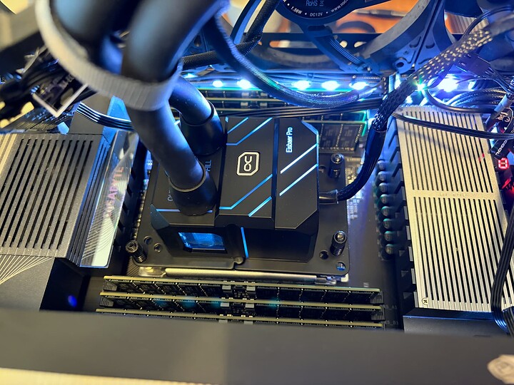

Lil update: went back to full air cooling and finally swapped in the ASUS board.
Lesson of the day: this ASUS board (unlike some very close relatives) does not support SATA-mode for the SlimSAS connectors, so the LSI stays for now, making good use of the one PCIe slot that is x8 anyway. The choice for mini-DP for the loopback is also inconvenient, but at least they include a cable.

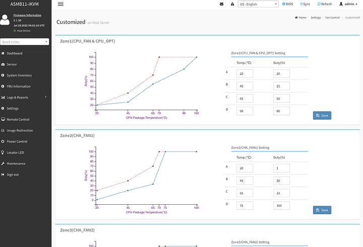

But, this board is so much better, even just having a java-free built-in KVM and remote fan control API without messing with proprietary drivers is so nice. Also: active dual-sided cooling for all M.2. The web BMC even exposes most BIOS options, though PBO is sadly missing, that would have been cool :smiley:
