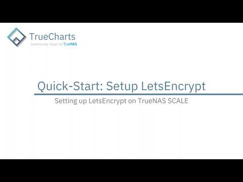

TrueNAS, in particular, has a form to get you signed certs
On Core they only support route53 dns, on scale they support rout53 and cloudflare. You do NOT expose anything to the internet with this method - it uses a dns challenge.
I would start there, since you have a domain with cloudflare.

I think it was this one - it was definately short and quick enough so you have to stop and start the video to keep up.
Also try:
