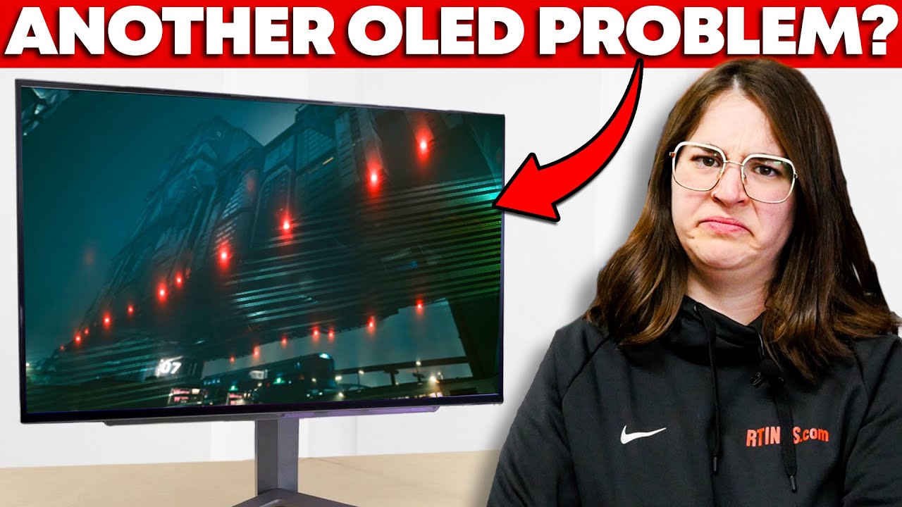

I never used vrr myself, but I heard of it when I investigated what the hell was my failure mode with that dp convertor.
Its weird brightness flicker:
Edit: Hmm, some reddit user submission actually match what I’ve seen on LGC2, just without black frames.

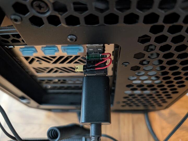

I bought a pair of cheap DP1.4 Adapters that originally are intended for easier mating since they get rid of the DP hooks.
Opened one up and added a jumper for pin 20 so I can reset the device that way. This works as intended. Next steps would be to use a transistor to trigger the resets from the PC.
