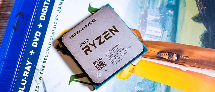

Is this temps normal (Ryzen 9 5900x)?
I use my Ryzen 9 5900x mostly for gaming and it usually runs around 76-80C turboing to 4.2/4.3 GHz.
Recently I’ve been studying chess engines and the temperatures are higher for my taste and the frequency drops by some margin.
On the screenshots, I’m running stockfish 2850 elo with all 24 cores (around 14Mn/s) and the temperature spikes to 90C with the frequencies around 3.9GHz
The cooler is a Corsair h115i
