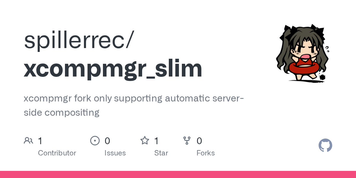

I have been using xcompmgr (with openbox) as I wanted something as minimalistic as possible without bloat in a hope of higher performance. After experimenting I found that the automatic server-side compositing mode worked the best for my needs. (I do nearly all my gaming on Windows, so limited experiences there.) Screen tearing was mainly affected by the options in the nvidia-settings and I could only get it to work well with ForceFullCompositionPipeline.
Since this is without any effects, I decided to remove it from the code to reduce dependencies and to be able to fix issues if I ran into some. You can find the result here: (I can provide a AUR pkgbuild if anyone is interested.)
I was really disappointed to see it ended up just being a call to X which then does everything. I still have some issues with mpv being laggy for a bit if dragged to another monitor, though I am surprised I am somehow avoided screen tearing in mpv even though the monitors are not the same refresh rate. (It was definitely an issue in my old configuration.)
