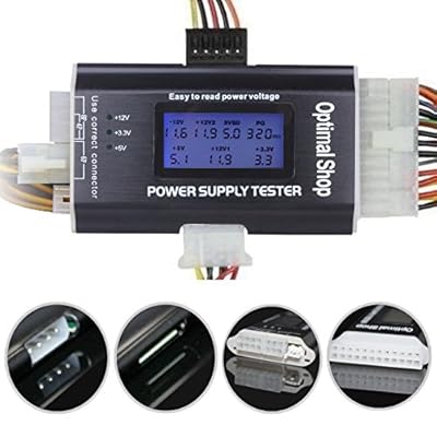

if you suspect your psu is shot get one of these. I keep one around the house at all times.
