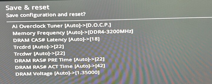

The only thing i have changed in the bios of any consequence is setting the DOCP on to 3200 for memory, but everything is on auto. Been running for years this way with no issues.

Once that proves stable, will turn on the DOCP (ram speed from 1600 to 3200) and see if that is what is causing the instabilities now.
EDIT2 (24 hours after previous EDIT): Made the changes and still no reboot.
Time to enable the DOCP setting as it seems that might be the one causing the issue. Weird because it never did this before.

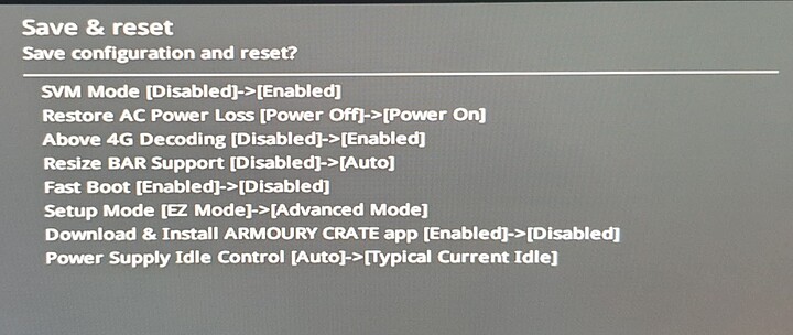

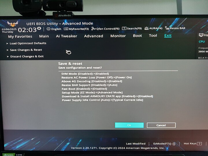

Settings Changes from default

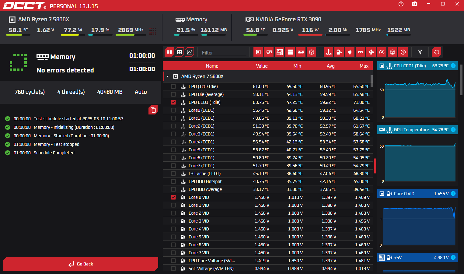

As said before occt is great for sniffing out issues. When doing tests make sure if you want to test the ram on occt; don’t use high cpu core count(use 2-4 cpu) with the ram test. If there is a issue with the cpu the ram will still fail with high cpu. Best to test both separately.
Thanks. Will leave the machine up for a bit to make sure that it is the DOCP causing the issue, then will try the OCCT to see if I can pinpoint it.
Memtest running under DOCP had no issues for a full run, so will be interesting what OCCT returns with. I will update in a few days.

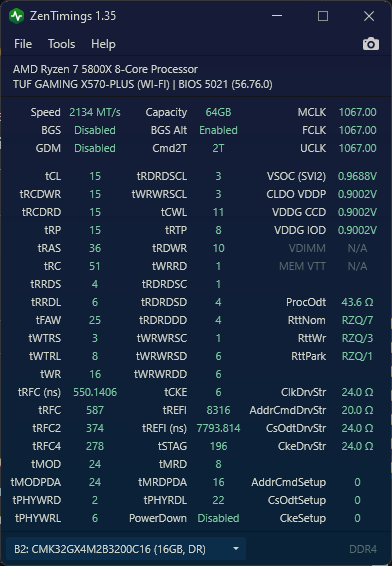

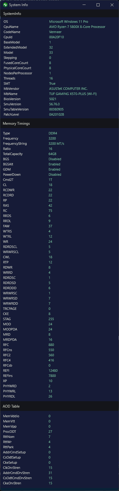

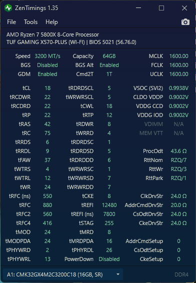

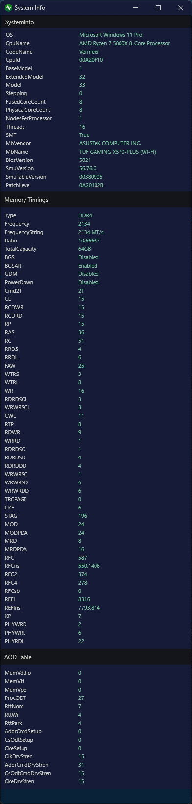

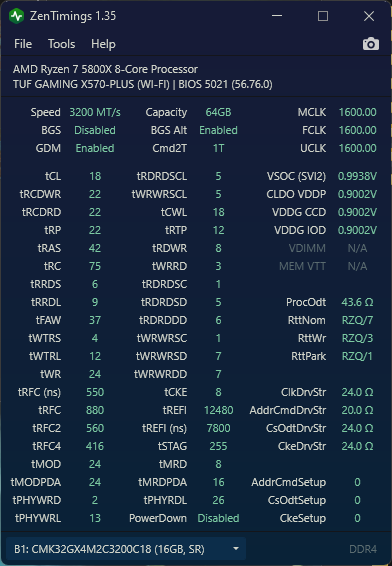

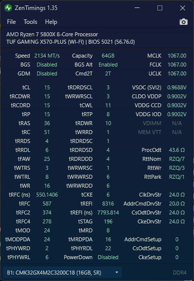

I’d recommend taking a Zentimings screenshot with the board under defaults, and another with the DOCP mode enabled. That will make it easy to determine what’s changing to narrow things down.
DOCP auto vs. On
| auto (off) | on |
EDIT: Been trying to make them next to each other to compare, but not sure how to do it in this forum. Got it working fine in Joplin Markup.

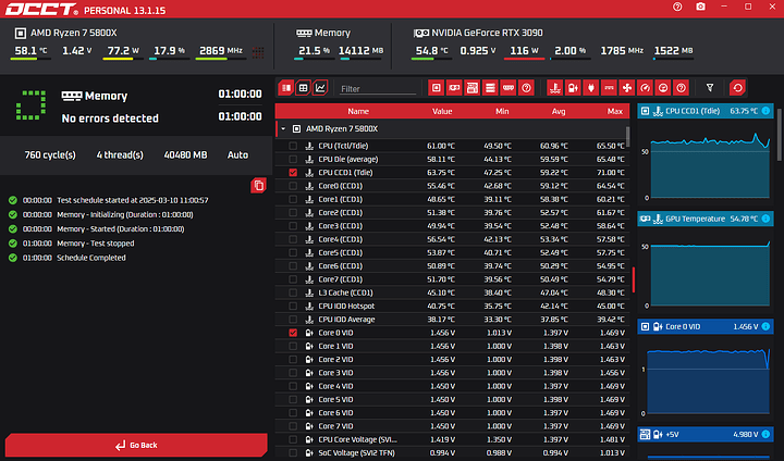

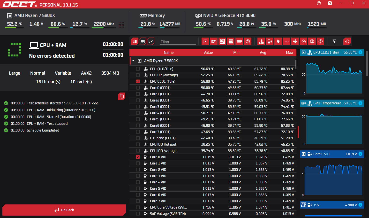

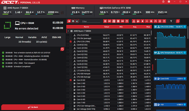

Ran both tests. Ram only the CPU+ram and both returned no errors (with DOCP on). Cinebench also runs fine.
Cannot find any faults with system, except with DOCP on it get that error when idle and reboots. Never seen it happen under load.
NFI, what is going on, but if I don’t want to get back to a rebooted system I have to run with DOCP off.
