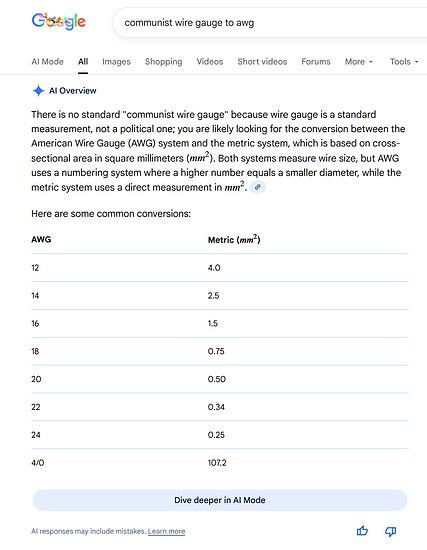

slightly OT brainfart "AI" helped me with
apparently it’s early enough in the morning I couldn’t remember what the SI system was called so I tried to explain to Google’s “AI” what I was looking for and it actually understood:
