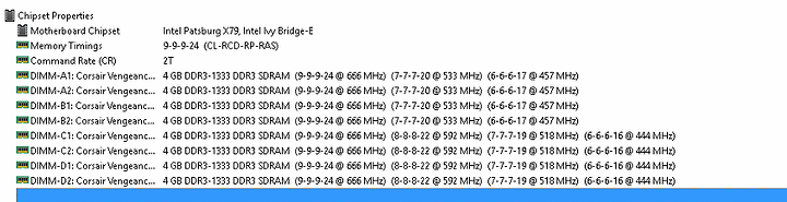

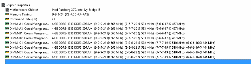

Example of my config with 2 different types of DDR3 1600 memory in 2011LGA
Here’s example of Quad Channel with different clock state mem’s (XMP is getting them all to 1600MHz)
but voltages are different
A1 1.2v
B1 1.3v
C1 1.2v
D1 1.3v
Channels
(A1, C1)
(A2, C2)
(B1, D1)
(B2, D2)
