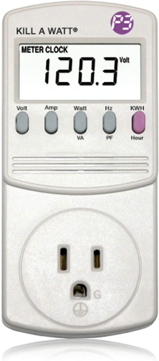

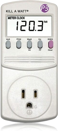

If you have it available to you I’d use a kill a watt device that will give you actual readings of how much power a device is using.
Something along this line:
Secondary question is are both power supplies plugged into the same electrical circuit to the breaker? usually 1600 watts is only good for a 15 amp breaker.

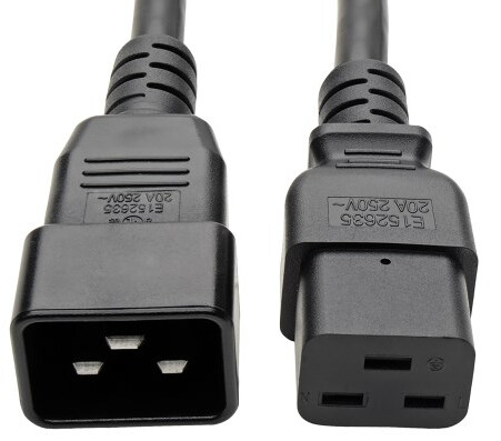

Good questions. Indeed, I have a kill-a-watt. However, because of the 15amp breaker problem… I had a 240v 30amp circuit put in. So my outlets and plugs are all weird now. C19 C20

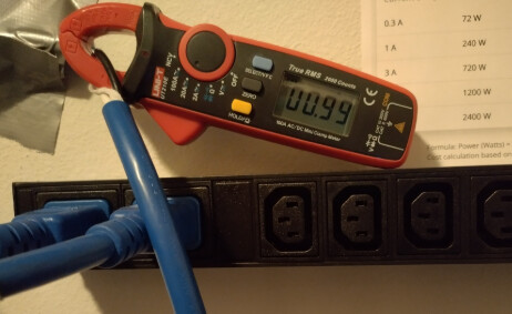

I sacrificed a power cable so I could put a clamp meter on it. However when I rebooted, two of the GPUs were undetected. (sigh) So now I’m distracted by that side-quest.

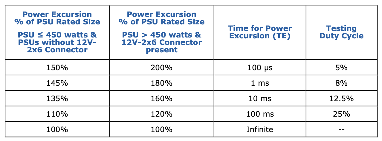

Unfortunately the claim made there about excursion handling is high by an order of magnitude for supplies over 450 W and wrong for lower rated supplies. See Table 3-3 in the ATX 3 design guide for correct values.

I stand corrected, cheers for the source.

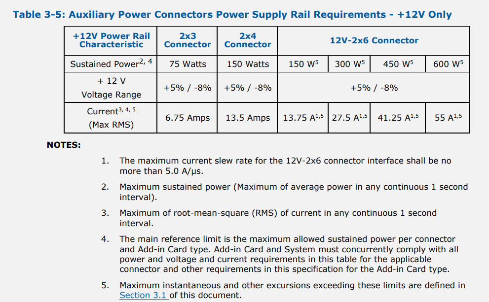

BTW this is the table:

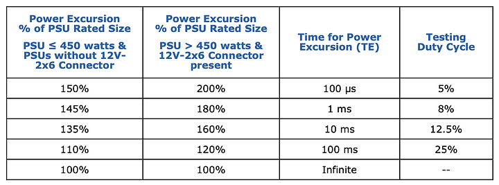

although I am not sure how this goes together with this table from the same doc:
So if I have a 600W GPU, it is allowed to consume 3*600W = 1800W?
And is that only that the ATX specification allows that, not that the PSU necessarily is able to do that?
So in theory I could have a 800W PSU, that can endure a 1600W peak.
But since its 600W 12V-2×6 cable allows for 600W * 3 = 1800W
this could trip my PSU?

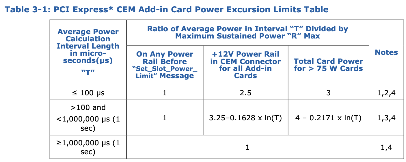

The table concerns Add-In cards what sort of spikes they are allowed to pull before the mainboard or PSU is to assume fault.
For the >75W cards, a 0.2 ms spike would allow for a 35% overload:
4 - 0.2171 x ln(200,000) = 1.35
Yes, but for less than 0.1 milli seconds.
And Note 4 is also to be observed at all times:
