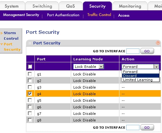

If your hardware supports it you can also use port authentication and port security to prevent someone from unplugging a camera and accessing your network.
http://www.smallnetbuilder.com/lanwan/lanwan-basics/30848-smart-switch-how-to-part-2-security
I was experimenting with that - but either I am not aware how, but I more think that my HP switches don't offer that.. and the ubnt cams can not authenticate against a radius server.
