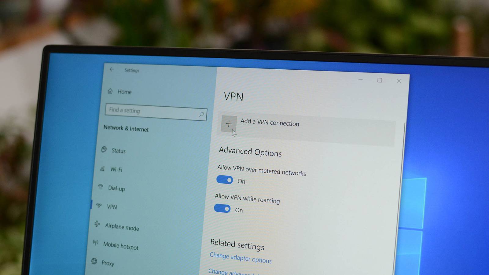

Rather than make the cameras publicly addressable, can you configure your router so that you can VPN into it? That way you can leave your cameras with non-routable private addresses (192.168.x.x for example), behind your router’s firewall, and any camera access you perform whilst mobile is encrypted (thanks to the VPN) and thus secure from prying eyes?
Most people are familiar with using a VPN to connect from their home network to a remote host and access the rest of the Internet via that, but it’s the same principle to connect from a remote device (e.g. phone or laptop) to your own router and access your home network via that.
Lots of articles exist describing the basics of how to VPN into your home network, like this one:
A good router with in-built VPN capabilities is, by far, the easiest approach, IMHO. Your current router might even already have that capability, which means you just need to turn it on a do a bit of configuring.
