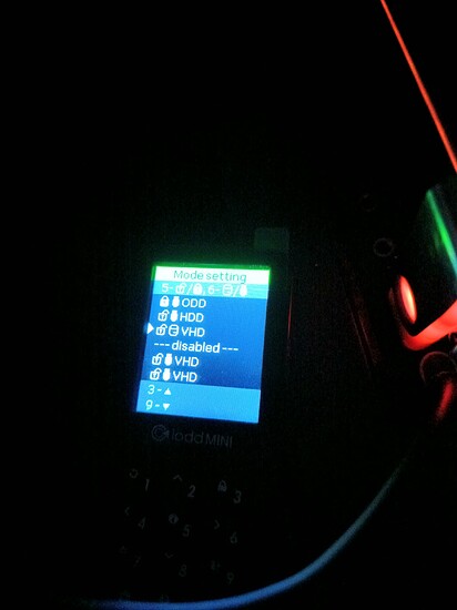

oh hold on, if you press the 6 key the VHD mounter changes from this
to
and then reports as a USB flash drive:
I didn’t even know the IODD could do that.
