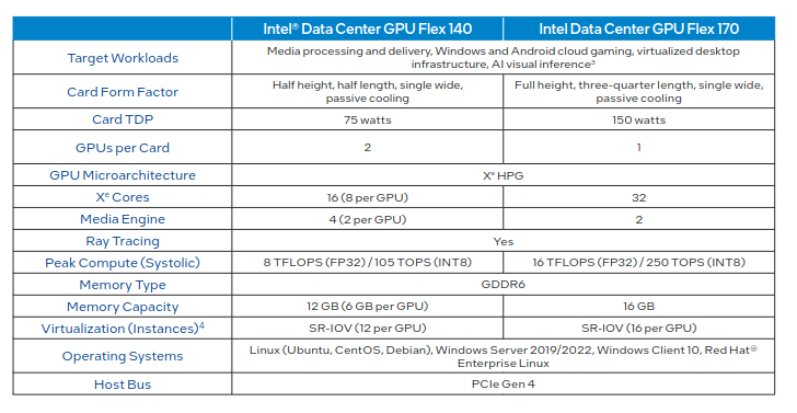

Does anyone know the allocation ratio for these flex gpu’s? I wanna buy/requisition a pizza box server with 2 flex gpu’s but wondered if it was possible to assign those 2 gpu’s to 4 vdi client’s in an esxi horizon pool?

Is this a 1:1 allocation (1 real gpu to 1 vdi instance) unlike the vcpu allocation insanity we already have.

https://www.intel.com/content/www/us/en/products/docs/discrete-gpus/data-center-gpu/flex-series/vdi-solution-brief.html
I would say that 7:1 would be a reasonable vdi experice for data science with flex170s. So 14 people, about 2gb vram each? Vmware is even more advanced than sriov in that you can have asymmetric allocation
