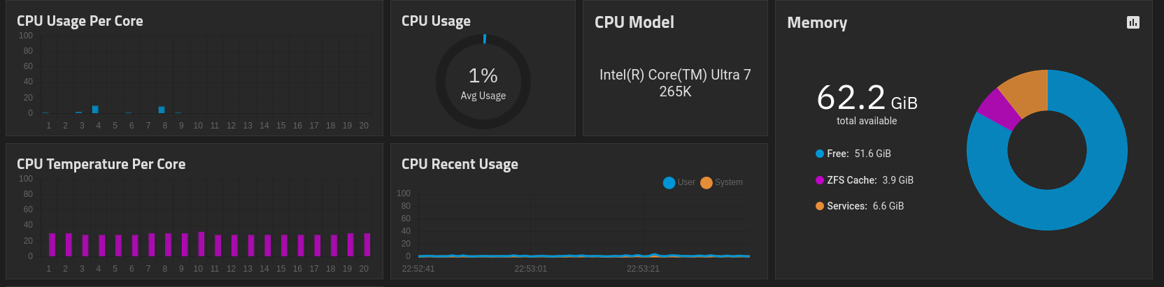

Sorry for the late reply but wanted to do a follow up on the homelab build using arrow lake with TrueNAS.
So far no iGPU in ElectricEel-24.10.1
ls -alh /dev/dri
shows no devices
so does
intel_gpu_top
Not even gonna try messing with the NPU
