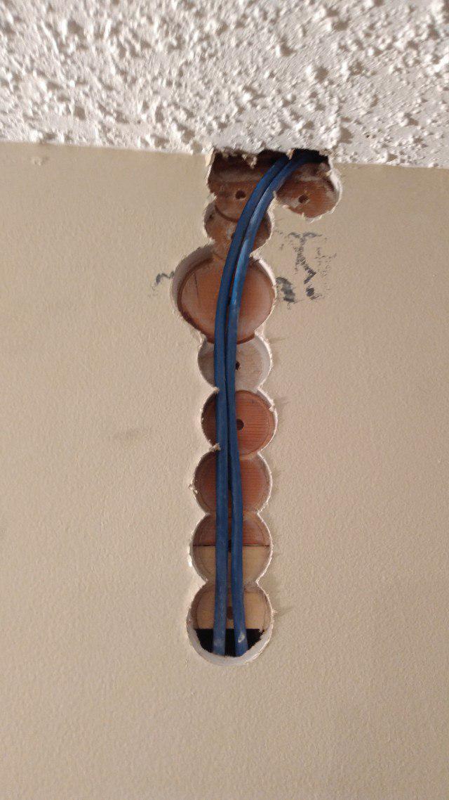

One of these holes is where I broke off a $45 flexible drill bit, forever stuck in 7" of wood that took me 5 attempts to properly get through.
Do not give up until your devices are wired in! All of my desktops are now wired together and it’s great. The wife barely notices all the holes in the wall. The trick is to cover them with drapes and furniture.
We had to go through a 4"×4" wall cap to get to the interior wall, so I know your pain. No broken bits though. Gotta clear the chips every once and a while.
This hole is as deep as the board is wide.
