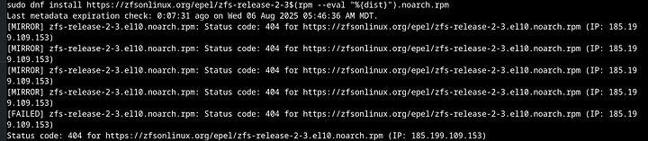

I have had a NAS running on Rocky Linux 9 for a while and the root drive recently died. I took this as an opportunity to upgrade the entire system except the relatively new storage pool. I am attempting to get my existing zfs pool up and running on my new Rocky 10 install but am running into issues. when I follow the instructions from openzfs, I am getting a 404 error. I assume this is because RHEL 10 is just so new. has anyone had any luck getting ZFS up and running on RHEL 10 or am I just going to have to go back to Rocky 9 and wait? I have confirmed that my process works on Rocky 8 and 9.
Yeah, this is an issue with Rocky 10 being new and ZFS’s repos not having caught up with it. The packages are currently unsigned, but hopefully they’ll add the repo (containing the signed packages) for EL10 soon.
