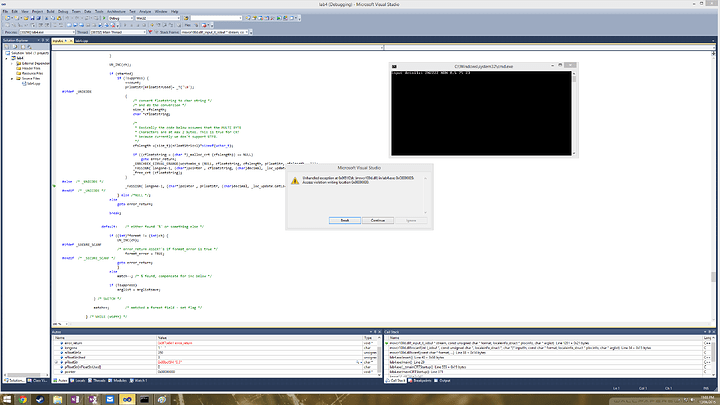

So my probelm is as the title says. I need to fill up the stocklist array with data in putted from the keyboard. My code runs, but crashes after I enter data for the first member of the stocklist array…
Attached screen shots and code.
Any help is appreciated, thanks!
