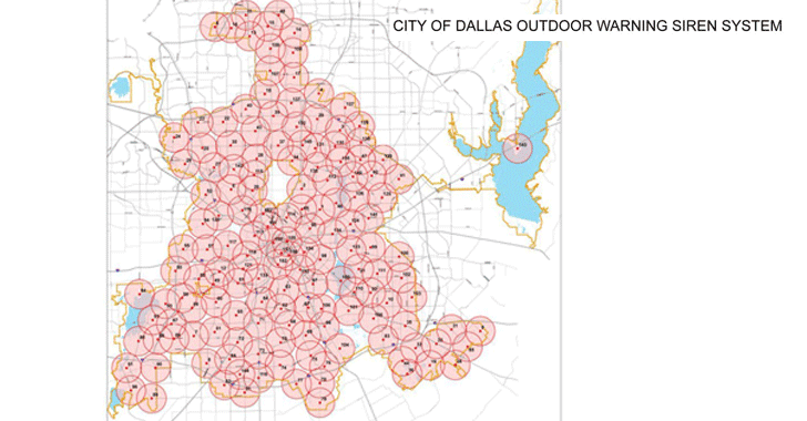

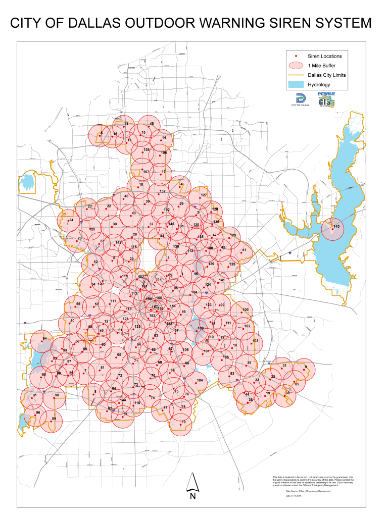

The Dallas EAS system is comprised of 156 Sirens distributed across the city.
