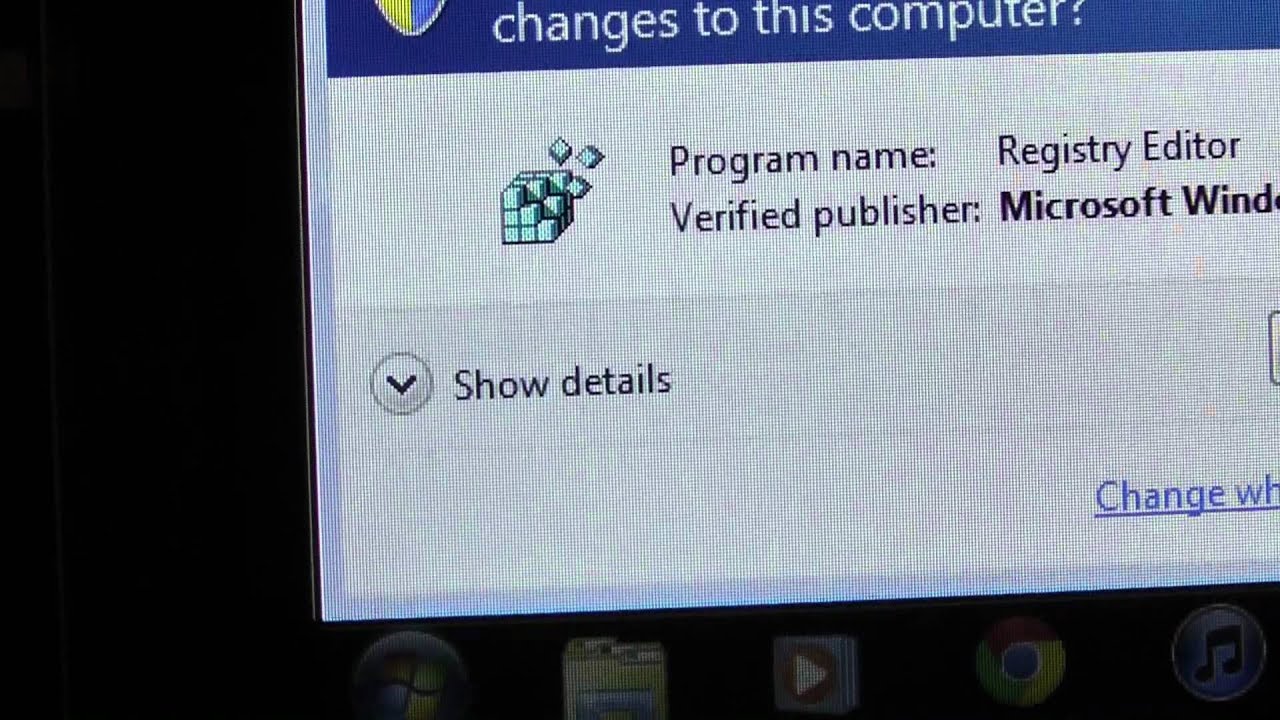

Found this video. Is it still relevant? Going to finally build my PC this weekend. Anything else i need to know to increase the life of my SSD and make sure it isn't doing any unnecessary BS?
Mostly just disable the paging file for it, possibly disable the recycle bin. and just make sure TRIM is enabled.

This video covers most of the basics, which are: make sure sure SATA mode in BIOS is set to ACHI before installing OS; disable paging file; disable prefetch/superfetch; turn drive indexing off; make sure SSD is being optimized, not defragmented; move any high write program temp folders from SSD.
Of the above, I personally make sure to enable ACHI SATA mode in the BIOS; turn off drive indexing; make sure to not defrag SSD (not really an issue on Windows 8-10), move high write temp folders. I did have the paging file disabled although I had to re-enable it for some game to work. I also did have prefetch/superfetch disabled before I updated to Windows 10; which I have only just rememberd. I may or may not disable it; I remember it being a bit of a bother to disable.
