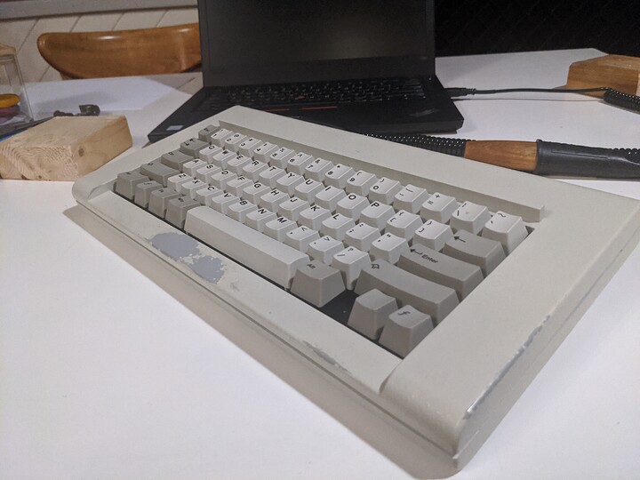

Some people have had issues with scratchy keys and paint peeling. I haven’t seen anything like that on mine. The paint peeling thing looks like it might be a case of a guy who just needs to take a shower, it looked almost like the paint had dissolved in the spot where you would rest your palm.
Good to know that “being too fast to daily drive the beamspring” isn’t just something I thought I was doing wrong lol
He needs more than taking a shower! That paint is gone all over the place.

Regarding paint wear - old news - this was with the original production keyboards that started shipping over 6 years ago. 5 years ago, the paint formulation changed to a more modern, tough powdercoating that has received zero complaints of premature wear. Bottom line, if you want tough powdercoating, pick a model besides the classic style F62/F77. That’s the only one with the paint-wear issues. The originals still have some stock remaining (with full disclosure of this, and now sold at a hefty discount), which is why it’s still brought up every now and then that these two old models can be bought today and will have the old coating because they were made a long time ago.
