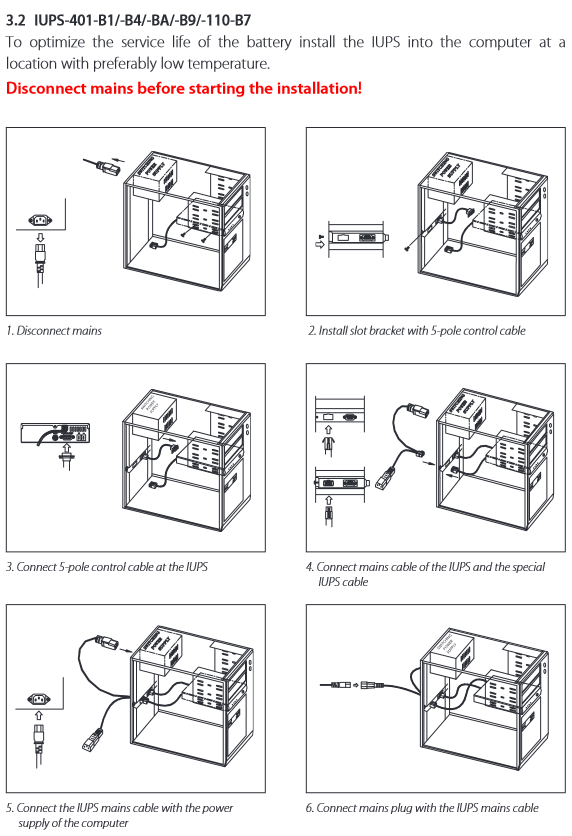

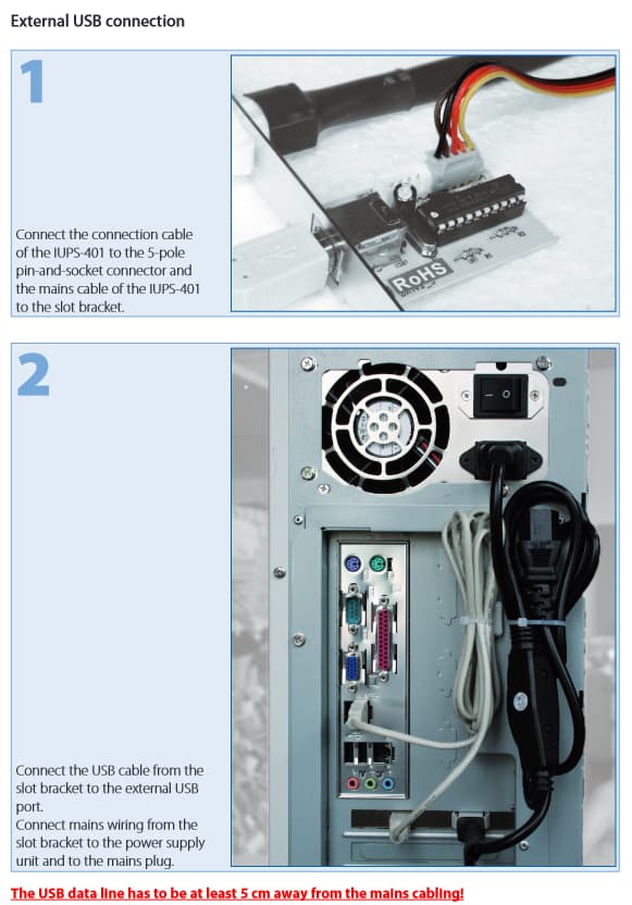

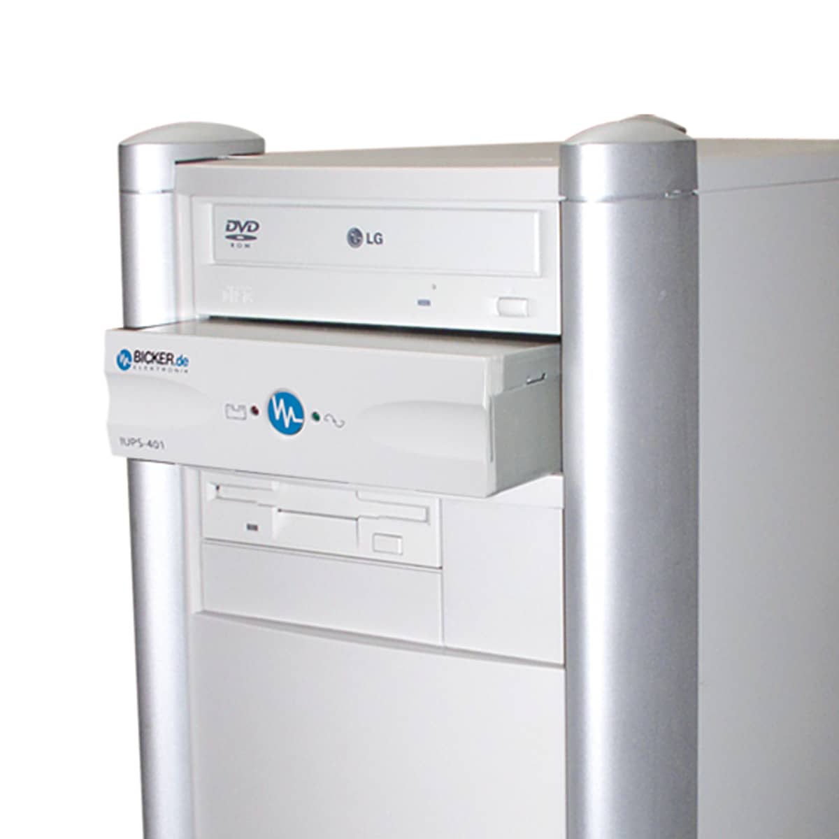

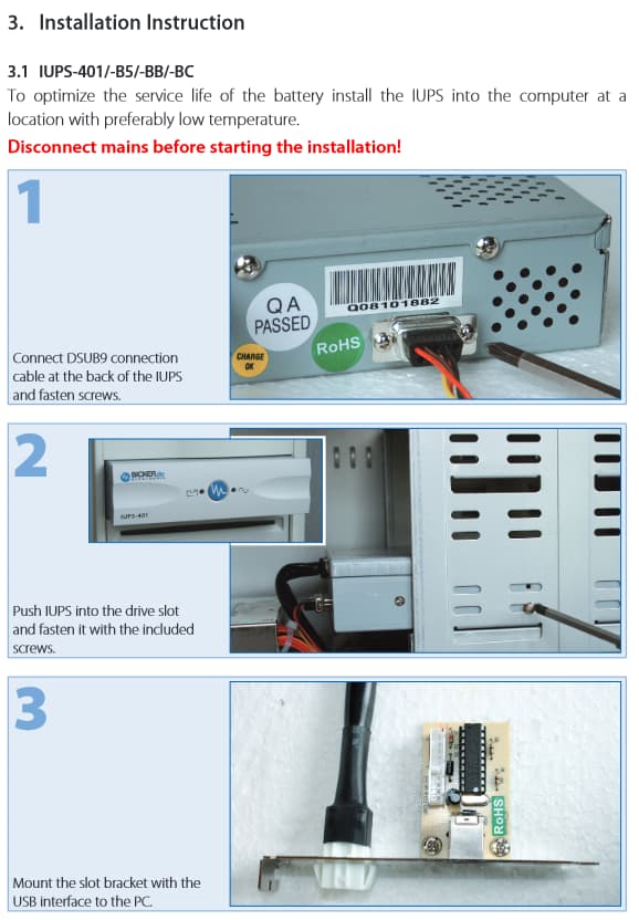

Or, something like EMC 078-000-050… :wink:
If someone has fantasies and free 5.25 bay and excess $ then I would choose these ups above. Of course the pc can’t be an electric beast. :wink:

Looking at the price(s) and the ease of use of these products I can only wonder why it hasn’t caught on (e.g. compared to a standard 1500VA UPS unit).
That’s a really cool idea, unfortunately I just ran out of 5.25 expansions :slight_smile: But both seems to follow my idea of a smaller UPS. Don’t have to be able to run the computer for 10 minutes if it’s just gonna do a clean standby/shutdown.
When it comes to 5.25 bay, it is also possible to connect a monitor, provided, of course, that the whole set will fit in the power ups parameters. :slight_smile:
Very unusual, expensive, with a small capacity, but for some very unique applications, it is useful because they still sell, rather by quantity than individual pieces. :wink:
You can buy an external 5.25 bay and put it next to the pc. :slight_smile: Buy one and let us know how it works. :slight_smile:
